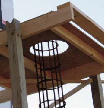

So that we could brace the top of the form and also be able to stand at the top while pumping the concrete, we cut a 14 1/2-inch-diameter hole in the middle of a sheet of 3/4-inch plywood; we supported the plywood on a lumber-framed scaffold just below the top of the form. This allowed us to drop the form through the hole and over the rebar cage onto the footing, then shift the plywood around on the frame to plumb the column before nailing it off. Wood blocks shot into the footing prevented the form's bottom from walking.
Temporary scaffolding provided a work platform from which to place the concrete, as well as a convenient support for the tube form.

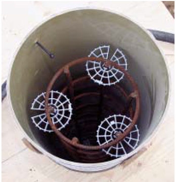

Plastic spacers centered the rebar in the tube; note the smooth, reflective surface of the form’s inner surface.

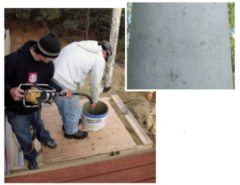

Periodic vibration during the pour helped the mix consolidate around the rebar and against the form’s surface. Even with vibration, the column’s surface had small pits and voids (inset); these can be easily grouted flush if the customer wants.

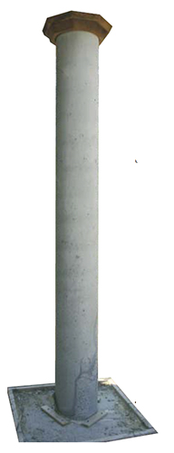

We used a 4,000-psi concrete mix; 3/8-inch aggregate helped it flow around the steel cage. We also vibrated the concrete to ensure full, even distribution. After the mix cured and we stripped the forms, we found only a few small pits and voids in the concrete surface. Curiously, the bottoms of the piers had some discoloration — probably from the mix water leaking out and causing a change in the hydration process. Luckily, these spots would be covered by backfill. Other than that, the piers looked good. Including labor, concrete, staging, rebar, pump truck, and forms, the final cost for the columns was about $1,800 each.
