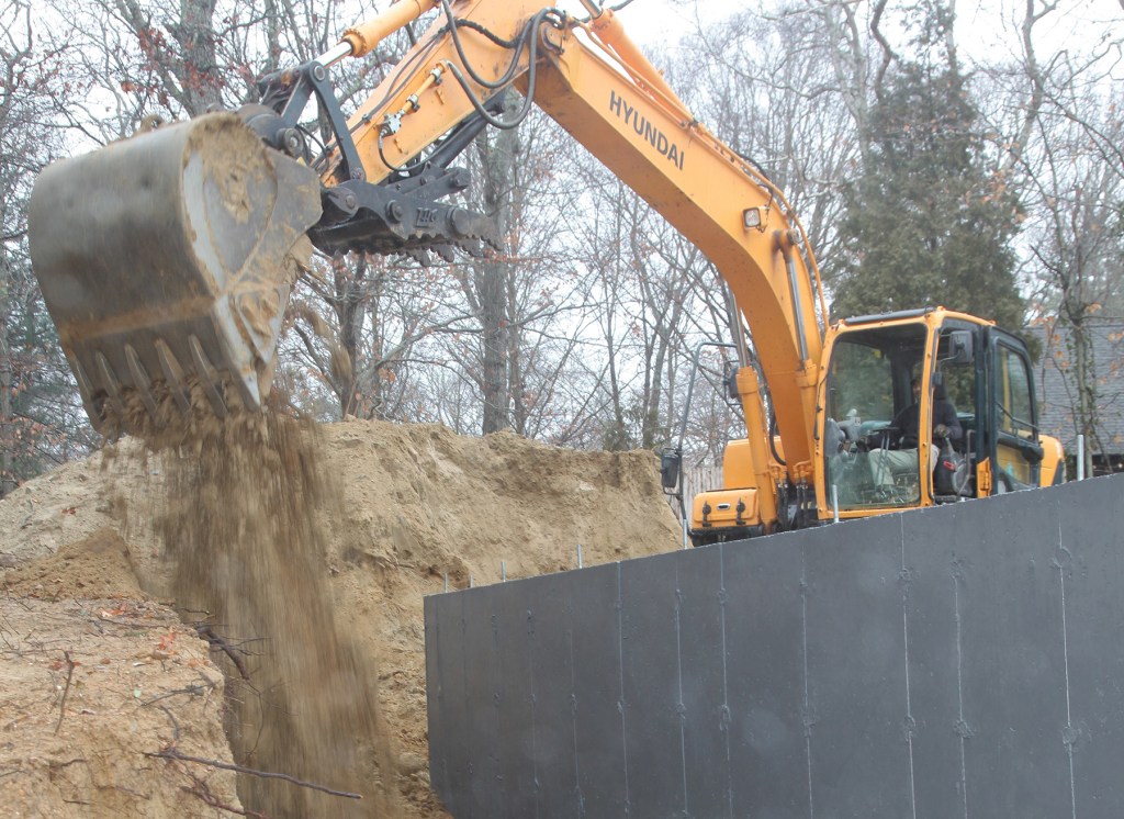

Waterproofing
Apply waterproofing products in the following situations: When soils are slow draining; basement walls are below the water table; drainage is unreliable; or the basement encloses habitable space (below).
Figure: Types of Waterproofing
Type | Pros | Cons | Comments |
Liquid Membranes | Quick application, low in-place cost | Possible inconsistency in coverage, 60-mil min. required | Follow manufacturer's recommended procedures carefully for voids and joints. Cement cove or fillet may be needed at footing-wall corner. Monitor coverage. |
Sheet Membranes | Consistent thickness, easy patching of holes, "fish-mouths," puckers, and wrinkles | High cost, tricky to use (sticks to everything) | Many details to learn -- surface preparation, priming patching, joint treatment, terminations, lap joints, penetrations, and corners |
Cementitious Waterproofing | Easy to use, readily available | No elongation -- will not accommodate joint or crack movement | Use acrylic additive for better bonding and durability |
Bentonite Clay | Nonhazardous, nonpolluting, easy and quick to apply, can go on at low temperatures | Cannot be inspected for integrity (seal forms after backfilling) | "Pumped-in" bentonite retrofits are of dubious value |
Drainage Panels
Some waterproofing systems employ a dimpled or expanded-fiber geomat fastened against the foundation, either with or without an additional coating material applied to the foundation wall. These drainage panels provide an immediate break in hydrostatic pressure, carrying water from the backfill into the perimeter drains.
