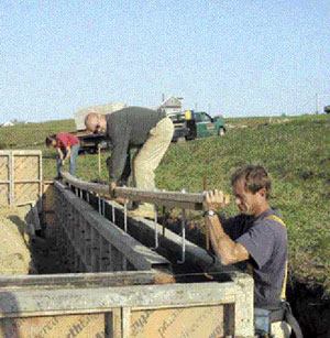

A few years ago, I came up with a method that works better for me. Before the foundation is poured, I cut and assemble the sill plates. I do the framing layout on them, and I drill and install the anchor bolts in the plates exactly where I want them. Then, just after the concrete is poured, I set the plates in place, bolts and all. I do a little thumping and tweaking, and soon the plates are ready for framing.

To begin, I cut the sills and assemble them in the lengths of the framed floors or walls. I'm careful to use straight stock, because there isn't any way to brace the sills straight in the forms.
In our area, we use double sills; the bottom one is pressure-treated, the upper one standard framing lumber. If there will be a conventional floor frame on the sills, the two layers can be permanently spiked together; if the upper sills are wall bottom plates (as on the slab foundation in the photos), I just tack them so that I can later remove the upper sill and build the walls lying flat.
Next, I establish a common layout for the building in both directions, which keeps the joists, studs, and rafters in line from sill to ridge. As I mark the layout on the sills, I can often shift other framing elements slightly to reduce waste and avoid odd-sized bays. For example, all the double studs for the shear walls in this garage incorporated one stud on the common layout.
I locate and mark any critical hardware, such as shear-wall hold-downs, so that no framing ends up in the way of these connectors. It's best to have the actual hardware on hand, or at least exact specifications, so the bolts can be set at the right distance from the members they attach to. I also locate any bolts specifically called for by code, such as those within 12 inches of beam pockets or corners.
If the top sills are also wall bottom plates, I lay out the framing for the entire wall, including studs, cripples, openings, posts, shear-wall studs, and any other framing members. Then I locate the anchor bolts where they meet code and make sense. For example, the building code or an engineer's spec might call for anchor bolts 32 inches on-center, but at a doorway it's clearly better to place the bolts just beyond the king studs on either side.
When I'm satisfied with the layout, I drill the holes and install the bolts in the sills. I label, organize, and store the completed sills, then wait for concrete.
