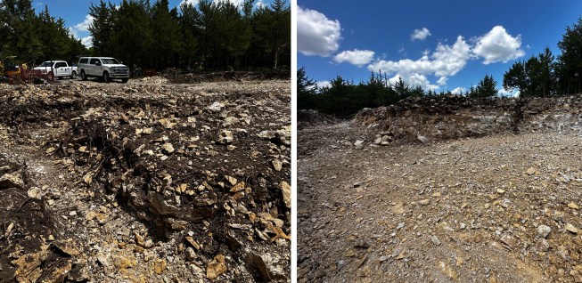

Roughly a foot below grade, the soils gave way to rock the size of a bowling ball. Not occasional rock, continuous rock. The excavation budget went up, the disposal budget went up, and the backfill plan had to be rewritten. The rocky conditions caused frequent collapses, which forced a much wider overdig than usual. We already dig wider than most builders in our area because we want working room for our team to feel safe to execute top-quality work. On this site, we were sloping far beyond even the OSHA expectations for Type C soils, simply to keep the sides of the excavation (rolling hills, really) standing.
What should have been a one-day excavation with a minor 6-foot cut turned into several grueling weeks of work because of an excessive number of rocks on the site. Excavation, disposal, and backfilling all took more time and budget than expected.

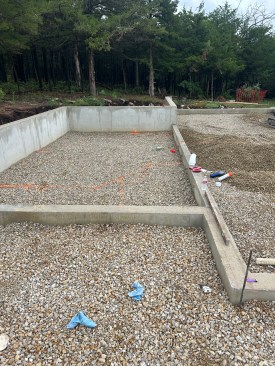

The goal was to get back to a workable elevation quickly without overspending on CLSM. We decided to place flowable fill only up to the level of the original undisturbed soil. This reduced the amount of CLSM required and brought our surface to a point where we could comfortably run a skid loader and compactor across the entire area. It gave us the result we needed while keeping the budget pointed in the right direction. It also meant we avoided burying any plumbing lines in the CLSM aside from a very short section of waste pipe at the foundation exit. Even at this elevation, we spent thousands of dollars on the CLSM.
The advantage of flowable fill is speed. CLSM comes out of the hose like a wet slurry, finds every void, levels itself, and requires essentially no manipulation. Our dozen-plus yards were placed in less than 45 minutes with one pump truck and one crew member. For any cementitious process, that is an incredibly efficient use of time and labor.

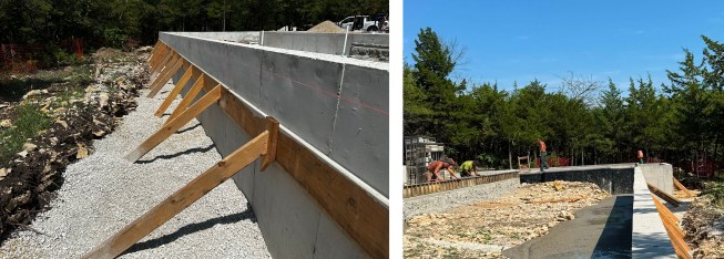

We braced the foundation walls prior to placement. With interior fill elevations higher than some of the exterior conditions and with the energetic nature of CLSM placement, bracing felt like the prudent choice. The walls did not move, the bracing came off easily, and everything performed as expected. We most likely would have executed this bracing with traditional fill as well.
Before the flowable fill, also known as controlled low strength material (CLSM), was placed, the author braced the foundation walls (left). Because flowable fill is expensive, the author used it sparingly to fill the enlarged excavations around the foundation (right).
A big advantage of flowable fill is speed. It comes out of the hose like a wet slurry, finds every void, levels itself, and requires essentially no manipulation.

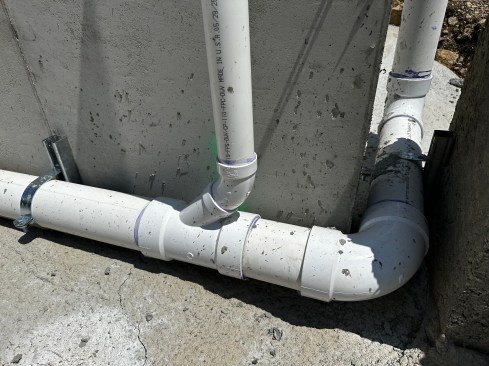

Finally, while ACI does not directly address plumbing embedment, I would avoid burying lines in CLSM unless it’s necessary. It is low strength, but it still locks things in place a lot more than compacted soil does.
The American Concrete Institute does not directly address plumbing embedment. Playing it safe, the author kept all plumbing and perimeter drainage above the flowable fill.
This was our first time using flowable fill. Everything went as planned. Performance so far is right in line with traditional backfill materials, and we gained days or even weeks in the schedule. Will we use it again? If the site conditions are right, absolutely. But those site conditions will need to be right because it isn’t cheap.
Conventional crushed stone was used for the remainder of the foundation fill.
