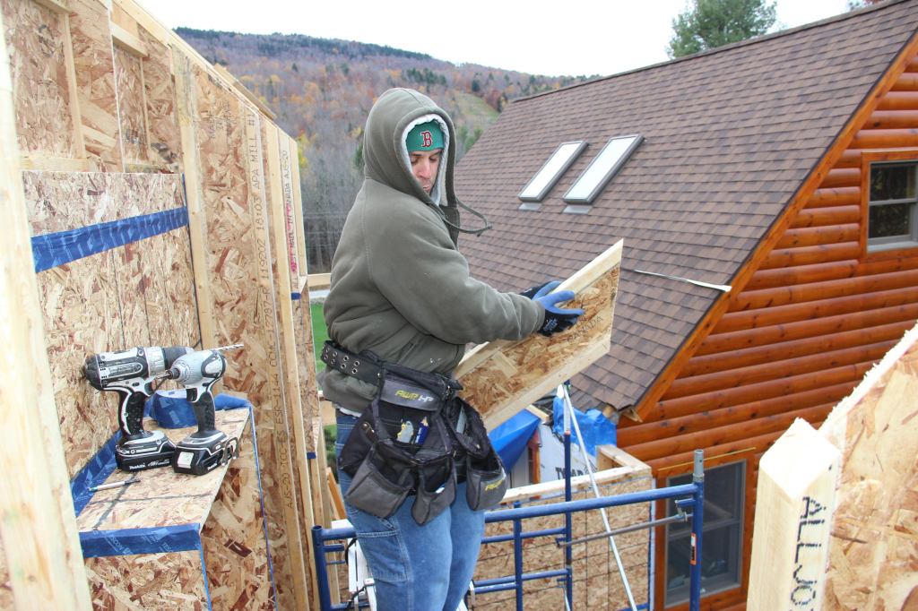

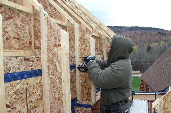

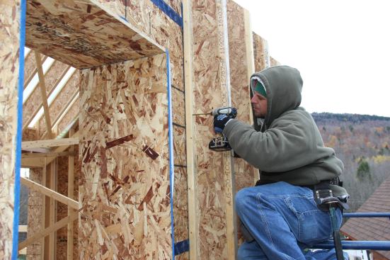

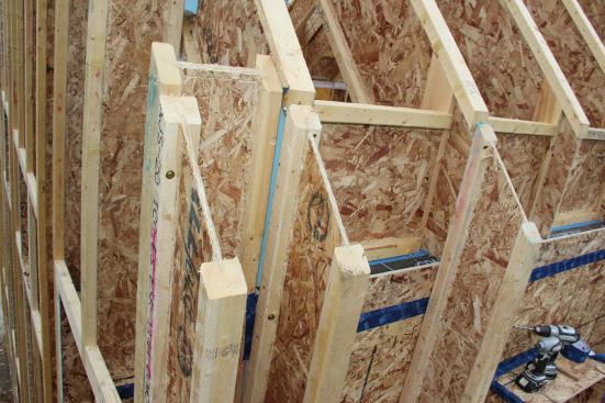

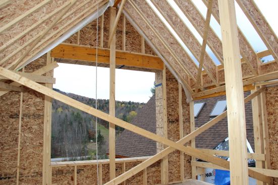

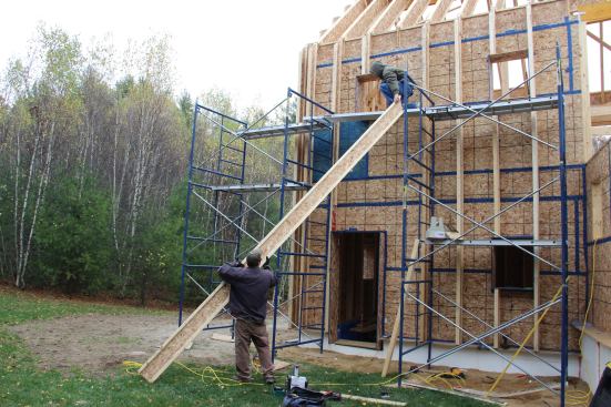

In our first issue this month, Coastal Connection visited a job site in rural Maine to follow the action as Jesper Kruse and the crew of Maine Passive House framed a two-pitch cathedral roof system with wood I-joists (see: “Framing a Two-Pitch I-Joist Roof,” October 13, 2014). Last week, we went back to the site to see the crew attach an I-joist buildout to the building’s walls, forming a wall cavity for super-insulation that matches up with the I-joist roof (see Slideshow left).
Kruse’s company specializes in custom Passive House houses, designed to meet the Passive House program’s strict limits on heating and cooling energy use. The architect for this project, Eric Sokol of Winkelman Architecture in Portland, Maine, didn’t draw the original building plans with Passive House detailing, but Kruse said Sokol liked the idea right away after Kruse proposed it, and was easy to work with. “I just showed him my typical set of details and explained how we usually do it, and he came back with drawings that applied our usual methods to this building,” says Kruse.
