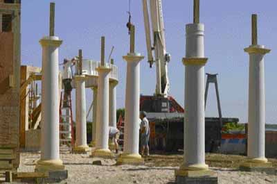

The hollow DuraCast fiberglass columns we worked with (Dixie-Pacific, Gadsden, Ala.; 800/468-5993, www.dixie-pacific.com) are structural members with a stated load-bearing capacity of 22,000 pounds. On the other hand, wind uplift, especially under an open roof in an exposed location, is at least as great a concern as bearing capacity. Although the manufacturer suggests using small, through-bolted L-brackets as column anchors, that wasn't suitable for this application. Instead, we used pressure-treated 4x4 posts, concealed inside the columns and connected to a concrete pier with Simpson CB44 post base hold-down anchors.
Anchoring to concrete. Mike nailed 2x4 blocking to both sides of the 1/2-inch I-joist web at each column's center location, providing a properly sized block to hold the Simpson anchors. With the anchors held in precise position, we were able to accurately place the pier forms below, on the footing. Each anchor was also encircled by a custom-made "nipple" form, made from bendable plywood. These were nailed directly to the underside of the I-joist flange. The resulting concrete nipple would fit inside the bottom of the fiberglass column and prevent lateral movement. Rebar, grouted into the footing inside each form, provided a positive mechanical connection for the pier.

After the concrete hardened and the inspector signed off on the work, we dismantled the layout grid and backfilled the area. We then installed the 4x4 posts using Simpson SDS screws in the base anchors. The 4x4s were 12 feet long, accounting for the combined heights of the column and the carrying beam, with some overage to be trimmed later. Setting the fiberglass columns followed immediately, so we didn't bother bracing the posts.
