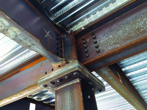

To keep the steel frame and concrete slab for the first occupied floor thermally isolated from a cold garage below, the architect and the Passive House consultant devised an insulated enclosure under the floor structure.

A 1-inch-thick fiberglass thermal isolation pad at the column-to-beam connection adds insulation value of R-2—not much but still significant compared with ordinary steel.

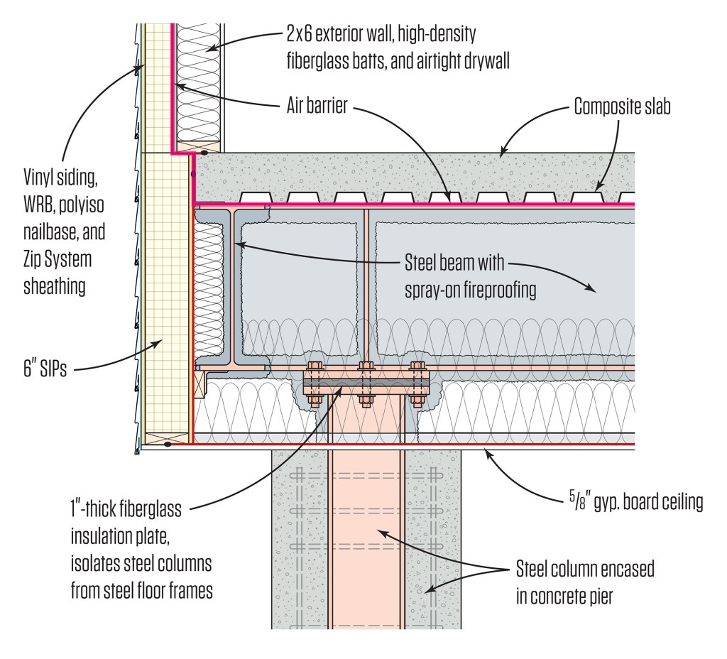

But the multifamily world can also pose particular challenges. This building, for example, was designed with a ground-level parking garage beneath two upper stories of apartments. The first occupied story above the garage would rest on a concrete slab, poured on a corrugated steel deck supported by a steel floor frame, all held up by steel and concrete pillars. Because of some issues related to soil conditions on the site, the steel frame was quite beefy. And because steel conducts heat so readily, thermal bridging was a major consideration.
As a Passive House consultant, my first suggestion was to keep all that concrete and steel floor structure completely outside the thermal envelope, by insulating above the slab, and framing up from there. But Wisniewski shot that idea down: If a waste pipe broke under that kind of insulated floor, he pointed out, it would be hard to detect the damage and even harder to repair it.
That one sentence—“we can’t do that because of the risk of a waste-pipe leak”—changed the whole approach. Instead, we had to find a way to keep the steel and concrete within the thermal envelope—and somehow minimize the thermal bridging between the steel floor structure and the steel columns that supported it.

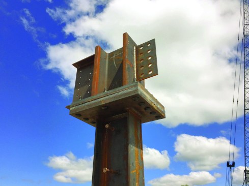

The solution came from a Passive House contact. We would isolate the steel columns from the steel floor frames with a load-bearing fiberglass insulation plate, as shown at left. The plate’s not a lot of insulation—only R-2—but that’s a lot less conductive than steel. Three-dimensional heat-flow modeling enabled us to quantify the heat loss at those connection points and account for them in our overall calculations.
The thermally broken steel-plate connection supports steel girders under the galvanized pan for the structural slab. All of the steel floor frame and the concrete slab ended up inside the thermal envelope.

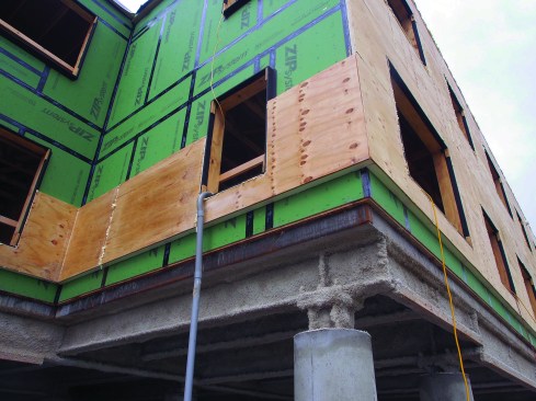

This view of the Elm Place building under construction shows the partially constructed wall with sealed Zip System sheathing and “half SIP” nailbase. The exposed steel and concrete floor structure seen here would later be enclosed with framing and insulation.
Michael Wisniewski
Wall R-values. Above is a view of the wall system we ended up with. It’s more heavily insulated than a code-compliant single-family house wall in Vermont, but less insulated than a typical Passive House. It’s a 2×6 wood frame insulated with high-density fiberglass batts, with airtight drywall on the interior face and Zip System sheathing with Zip Tape–sealed joints on the outboard side. Over the Zip System, we applied either a 3-inch polyiso nailbase panel from Hunter Panel or 3-inch foil-faced polyiso rigid insulation (depending on the cladding chosen for that part of the wall). This provides an R-value of about R-37 or R-39.

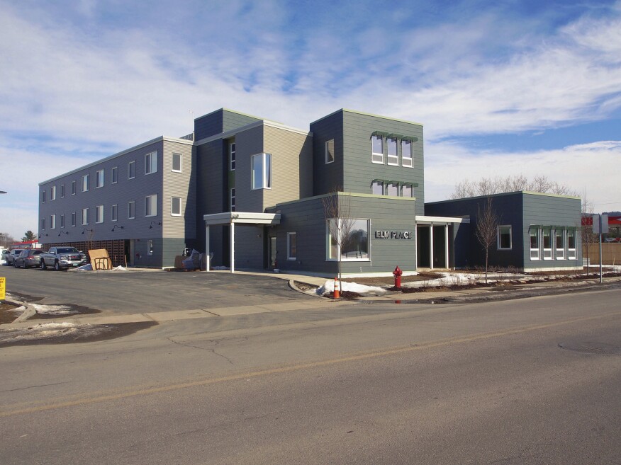

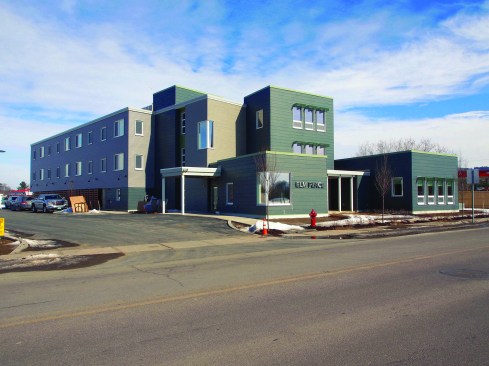

A view of the completed Elm Place project, with administrative and common areas near the street and apartments to the rear, above the parking garage. The building reached Passive House certification at an upcharge of about 2% from the client’s earlier Wright House project.
Michael Wisniewski
