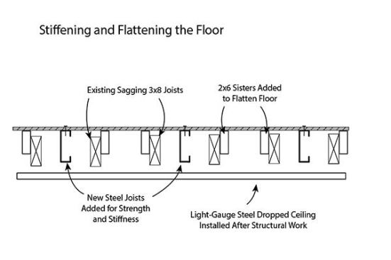

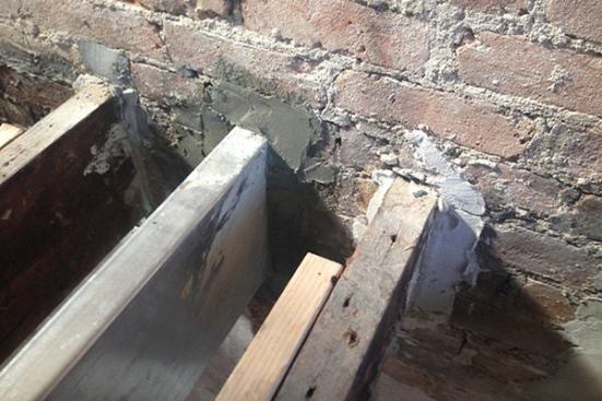

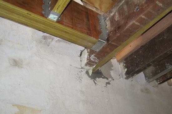

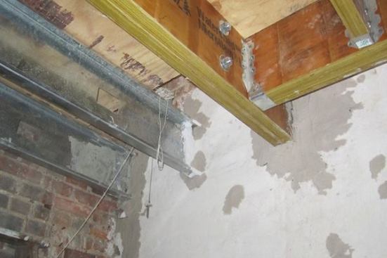

But if you’re not that accustomed to working in 100-year-old brick row houses, the project offers a few interesting structural wrinkles. In this set of photos, we take a look at the way the framers reinforce the old, sagging floor joists with new steel framing and engineered lumber, tie that new structural work into the existing brick bearing walls, and beef up the roof structure to handle a whole new set of loads from a rooftop patio and access bulkhead.
