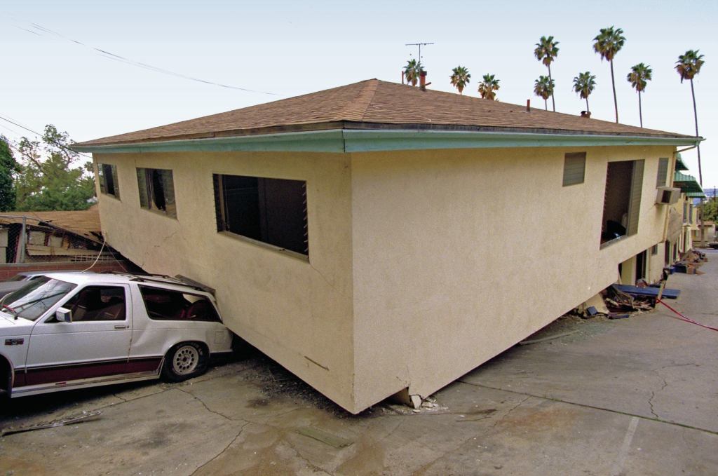

In an earthquake, shear walls help upper stories stay connected to the foundation, which moves rapidly back and forth. Without them, the movement gets too far out of sync, and the building “pancakes,” as in this 1994 photo from Northridge, Calif.
FEMA/Andrea Booher In an earthquake, shear walls help upper stories stay connected to the foundation, which moves rapidly back and forth. Without them, the movement gets too far out of sync, and the building “pancakes,” as in this 1994 photo from Northridge, Calif.

Unlike wind, “the earthquake doesn’t apply a force directly to your building," Pryor points out. "The foundations just move, laterally and up and down.” Pryor focuses on the lateral movement because good gravity design will handle the up-and-down motion, which is in the same direction that gravitational forces work.
The building’s inertia tends to keep it stationary, so shear walls and moment frames are designed to help the building keep up with the motion of the foundation. Without them, Pryor says, “you find a situation where the foundation is in one spot and the mass of the building is in another spot. If the difference gets too big, the weight of the building and gravity will just drive that building down. We call that ‘pancake’ or ‘collapse’—and that’s what you see in the ‘soft story’ buildings in Loma Prieta in 1989 and Northridge in 1994” (see “Eight-Penny News,” April/94).
Earthquakes are more powerful than wind, and it’s too expensive to fully resist their lateral forces. So engineers compromise. “Unlike a hurricane that blows in one direction for 20 minutes, an earthquake creates ground motion that goes to the left for half a second, then back to the right," Pryor says. "If you let the beam and column connections yield, you can design for a force that is one-sixth to one-eighth the force that you would need to keep that building strong enough to not yield at all.”
The good news is that if the design works, the building won’t fall down and kill somebody. The bad news, Pryor says: “Your building is getting damaged. We accept limited damage to the building, as long as the building doesn’t collapse. Your home may get red-tagged after the event, but nobody got killed.”
