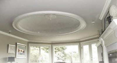

I would have preferred a deeper dome but didn’t have room overhead: Because the addition — an ell off the back of the house — was only 16 feet wide, I was limited to a roof pitch of 6/12. I settled on a diameter of 9 feet and a height of 2 feet measured from the bottom of the ceiling joists to the bottom of the collar ties.
I doubled the joists at each end of the dome area and added perpendicular double 2x12 headers to create a 10-foot-square opening. Because I had interrupted the continuous ceiling joists, I bolted 2x6 collar ties to the rafters above, to make sure the wall plates wouldn’t spread. Next, to create an octagon — the beginnings of a rough circle — I nailed 2x12s at a 45-degree angle at the corners. I then added a second member, a 2x12 ripped to 10 1/2 inches, on all eight sides. The step-up created by the narrower framing members would accept a 3/4-inch plywood ring that would turn the octagon into an accurate circle. Nailed to the bottom of the 10 1/2-inch members, the plywood would be flush with the bottom of the joists. A second plywood ring would go on top, sandwiching short sections of blocking to create a sturdy platform to support the dome rafters.

Plaster was the logical finish for the curved surface of the dome. The plasterer bent metal lath to the contours of the rafters and nailed it up with galvanized roofing nails. He applied a base coat of gypsum plaster followed by a smooth finish coat. The entire application took less than a day and turned out great.
I thought about making my own moldings to finish off the dome by bending various materials around the circular opening. In the end, though, I farmed the job out to a local woodworking shop. I assembled the molding profiles on the floor, then lifted the entire assembly into place. I had already drywalled the ceiling at this point, so I used construction adhesive and 3-inch screws driven into the blocking to attach the molding ring.
I looked at medallions in catalogs, but since I had the trammel handy I made my own simple version: I cut an 18-inch-diameter ring and a 6-inch circle out of MDF and routed the edges. I nailed the ring to the hub, plastered the inside, and nailed the smaller circle in the middle of the ring. A leftover stair finial completed the woodwork.
Overall, I was pleased with the finished dome, though in hindsight I might have made it a foot or so smaller in diameter. I sprayed the trim ring with an alkyd primer and satin top coat, but I left the plaster unfinished in hopes of someday finding a budding Michelangelo willing to paint an inexpensive Roman fresco.
