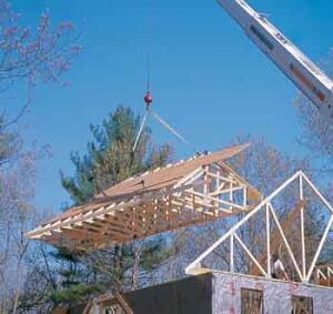

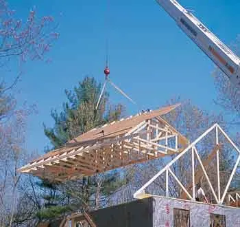

Several years ago, while discussing how to lift trusses for a hip roof, our crane operator suggested that I preassemble some of the components on the ground. I decided to give it a try, so I worked a little late that day, attaching the jack trusses to the girder trusses (see Figure 1). The lift went off without a hitch. On the next hip roof house I built, I went further with the preassembly and attached the hip trusses and corner jacks while the assembly was still on the ground. Even factoring in some extra time for head scratching, the method saved us time.
Figure 1. The girder truss (or hip girder) is the backbone of the hip roof truss assembly; most roofs require a double girder truss. Attached to the girder truss at right angles are the jack trusses (sometimes called the face jacks or end jacks). Extending at a 45-degree angle from the girder truss to the corners are the hip trusses (also called hip jacks, king trusses, or corner jacks). The short trusses that attach to the hip trusses are the corner jacks (also known, confusingly, as hip jacks or side jacks).
Nowadays, on a single-story house, I usually just attach the jack trusses to the girder trusses before the crane lifts the assembly, since the rest of the components are easy to install in place. But on a two-story house, it’s more efficient and safer to assemble as much as possible on the ground. These days I even sheathe the hip system before lifting (see “Installing Hip Roof Trusses,” 6/97).
