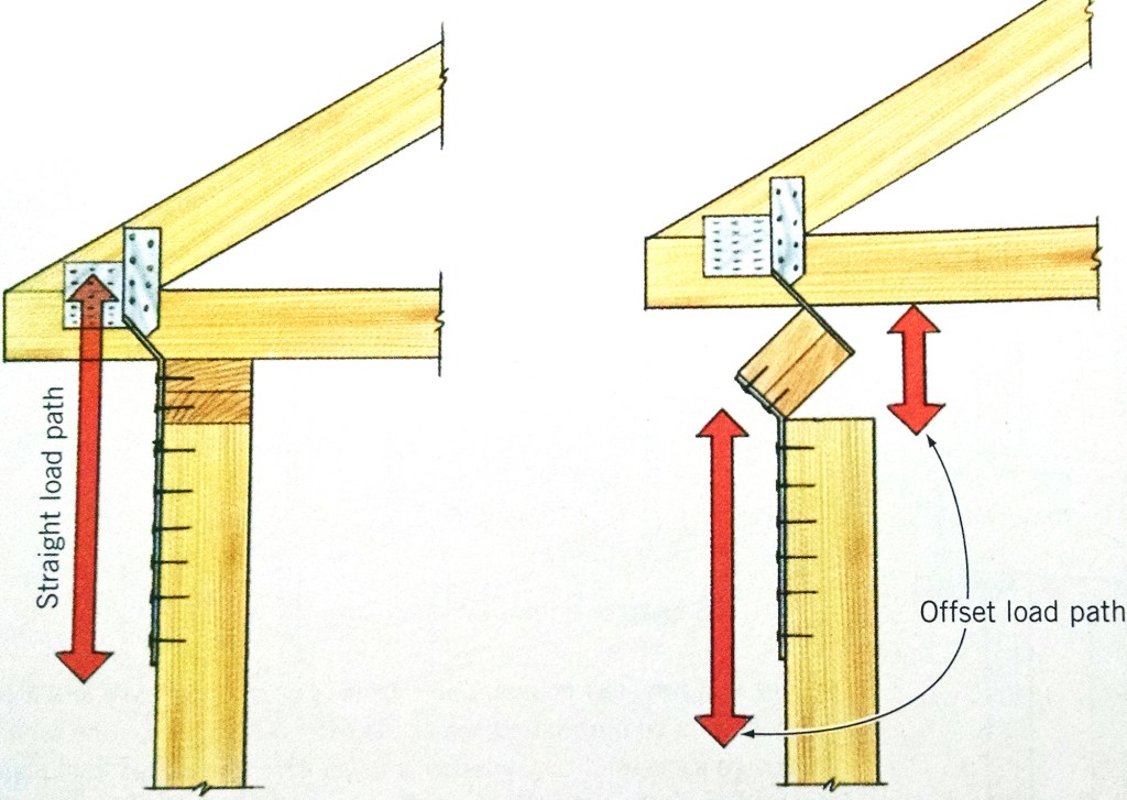

Direct Load Path
Truss or rafter ties should tie the roof directly to the studs in line with uplift straps, not just to the wall plate (left). If the connectors simply tie the inside of the wall plate to the roof framing, the plate can twist under a load, reducing the strength of the connection (right).
