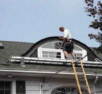

Over the years, the eyebrow dormer on my client's 1926 colonial had seen its share of bad Long Island weather. Though the trim was structurally sound, the paint finish was in sad shape. To protect the window from deterioration and minimize future maintenance, I suggested to the owner that we clad the weathered trim boards with 1/2-inch Kleer PVC trim (866/553-3770, www.kleerlumber.com). While PVC can be easily machined and sanded, just like wood, it's a lot more durable; best of all, I knew I could heat-bend it to fit the graceful curves of the dormer.
Initially, I thought I would be able to measure the dormer's radius and use math to lay out, cut, and shape the material on the ground. But after taking a few measurements from different areas of the eyebrow, I realized that the carpenter who had originally built the dormer had freehanded some of the trim; there was no way I could mathematically plot my curves. Complicating matters further, the width of the trim varied from 6 1/2 to 8 inches wide.

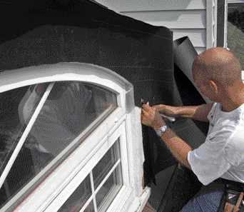

Since I didn't want to spend hours sitting on the roof scribing the trim in place, I made a felt-paper template that I could carry down to a workspace in the driveway, a technique I've used to make copper roof flashings. With an accurate template, I could replicate the trim on the ground.
To build the template, I stapled up sections of 30-pound asphalt felt paper so that they covered all the dormer trim without sagging or wrinkling. Then I used a sharp utility knife to cut out the borders of the trim.
In warm weather, 30-pound felt paper is pliable enough to fold, so cutting the roof outline accurately was just a matter of working the paper up under the roof edge and slicing along the top edge of the trim. The paper is stiff enough to provide a reliable template that won't stretch or distort when spread out on the worktable.
To help keep the template sections properly oriented, I cut a plumb line through both pieces of paper at the top middle of the template. I also snapped a reference line across the entire dormer while the felt paper was still in position, then made a couple of marks along this line on either side of the window and accurately measured the distance between them. Starting with the plumb cut and with this measurement for reference, I reassembled my template on the ground in the same position it was in on the dormer.

Protected by its weatherproof PVC outer layer, the eyebrow dormer is ready for another 80 years of service.
