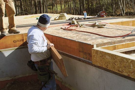

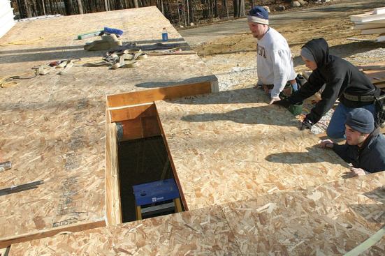

However, to shorten the site time for our road crews, we’ve started panelizing a lot of our floor systems in the shop, and setting the large floor sections on site with our crane. That helps us make the most of the on-site efficiency of SIP wall and roof construction; when we don’t prebuild, framing floors on site is the one part of the job that takes us as long as it would take anyone else.

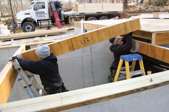

Insulated Floor for a Small Room

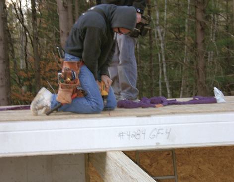

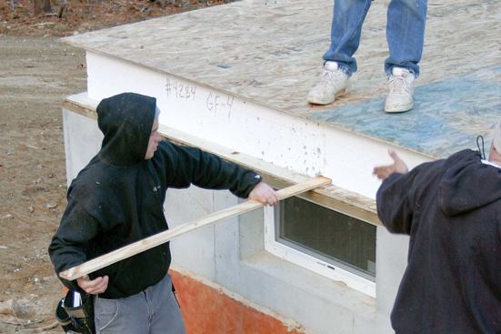

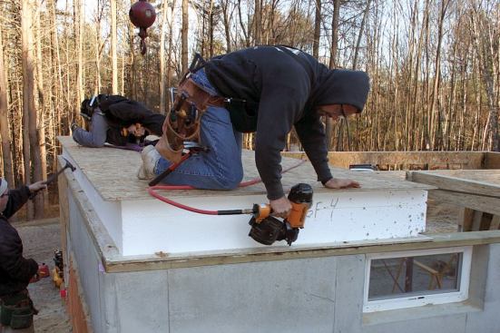

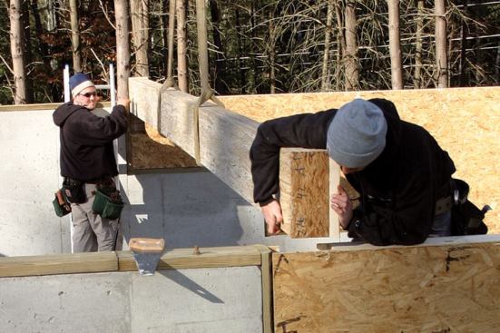

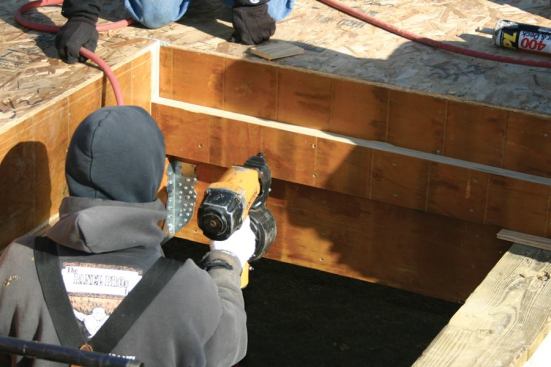

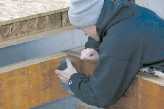

The floor of a small bump-out or room addition is one of the quickest and simplest uses of SIP technology. SIP blanks come 8 feet wide by 24 feet long, so we were able to cut this sunroom floor from a single panel. The floor panel bears on the foundation wall on three sides. Where it joins the floor frame of the main house, it attaches to an LVL ledger beam.
It’s common practice for us to sleeve a beam or structural spline into a space routed out of the panel’s foam. In this example, we placed the structural member first, and then slipped the panel edge over it. To do that, we had to remember to leave space for the panel’s OSB skin between the LVL beam and the member below it. We typically use a 1/2-inch plywood shim to space the beam away from other framing, leaving just a tiny bit of extra room to slide in the 7/16-inch or 15/32-inch OSB. In this case, the panel was a tight fit on the beam, so the crew had to use come-alongs to pull it snugly into position.

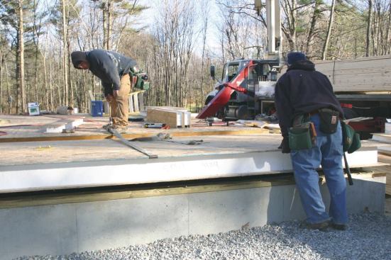

These spans are achieved without structural splines. If you use 4-foot-wide lengths of panel with LVL members embedded in the joints, it’s technically possible to achieve clear spans of as long as 24 feet. But when a design calls for long spans, we prefer to support panels from below with engineered beams, as we did for the floor over this house’s garage. That’s a simpler assembly to set up, and it’s also more convenient to air-seal at the seams.

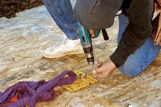

We lift the floor panels into place with the crane. Panel builders often lift panels using big steel hooks that they drive through the panel skin. We used to do that, but it’s frowned upon these days because of the surface damage it does to the panel. So now we use a steel lifting plate, which we screw directly to the panel. The plate accepts 16 screws, enough for a strong attachment.

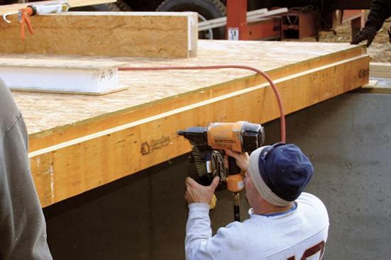

Once the floor is in place, its routed edge will be filled with an LVL rim joist. The LVL’s structural capabilities aren’t really needed in this location, but we use LVL because it’s stable. Ordinary lumber would shrink away from the panel, creating gaps and potential air leaks.

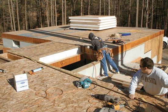

Insulated Floor Over a Garage
The classic SIP floor application is as an insulated lid for an unheated garage. This location is notoriously hard to insulate and air-seal in stick construction; with 12-inch SIPs, however, you can have a true R-48 floor with no thermal bypasses and virtually no leaks, after just a morning’s work.

Air-sealing matters, too, of course. The body of a structural insulated panel is airtight by nature, but joints and seams need attention. We seal every joint in the house with construction adhesive, expanding foam, or adhesive membrane tape. For a garage floor like this, we apply construction adhesive to the foundation sills before placing the panels; then, after all the structural connections are made, we inject expanding foam into the panel-to-panel joints.
We make the structural connection between adjoining floor panels by sliding splines into prerouted edge spaces and stitching the panels together with staples or 8d nails. Floor perimeters, as usual, get stuffed with LVLs (another spot where we apply construction adhesive). We fasten the panels down at the sills and at supporting beams with long, hardened-epoxy-coated screws (Trufast Corp., 800/443-9602, www.trufast.com).
