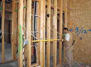

As an interior trim contractor, I know my work won’t look good if the framers are sloppy. That’s why I always carefully inspect the walls before my crew shows up — hopefully before the drywall is hung.
Sometimes, when it’s my first time working for a GC, the drywall’s installed before I even see the site. I’ll still do the inspection, but if I encounter surfaces that are lumpy, bowed, or out of plumb, I make it clear that unless the builder tears off the drywall and fixes the frame, the trim won’t look right. The builder has to do this only once to realize that it’s cheaper and easier to inspect and fix the frame before the drywall goes up.
The builders I regularly work for pay me to inspect the framing because they know that I’ll not only look for problems that will affect trim, but also point out other defects that may reduce the quality of the finished home. When I find a problem, I mark the area with spray paint and maybe write a note on the stud. The builder then has the framer — or another sub — fix the problems, and I inspect one more time.
When the repairs pass muster, the builder has drywall installed.

Walls
After that I check all the walls for flatness, using an 8-foot level as a straightedge and looking for gaps or bumps that exceed 1/8 inch. I examine the wall at several elevations and mark trouble spots with paint. The framers will plane the high spots and shim the low ones. It’s often easier just to replace any badly bowed studs. The goal is to make the wall as flat and straight as possible before covering it with drywall.
