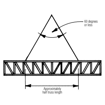

Figure B: Lifting Floor Trusses by Crane
When receiving a truckload of trusses, reject those with excessive splits in chords or braces, those with knots close to metal plates, or those with loose or deformed plates. Also reject any that show evidence of having been damaged and repaired. Beware of warped or wet lumber, which can set up dangerous stresses as it shrinks and dries.
Lifting With a Crane
If you use a crane, always lift from two points (Figure B) and never lift the truss sideways; the excess flexing can loosen the connector plates, causing eventual failure.

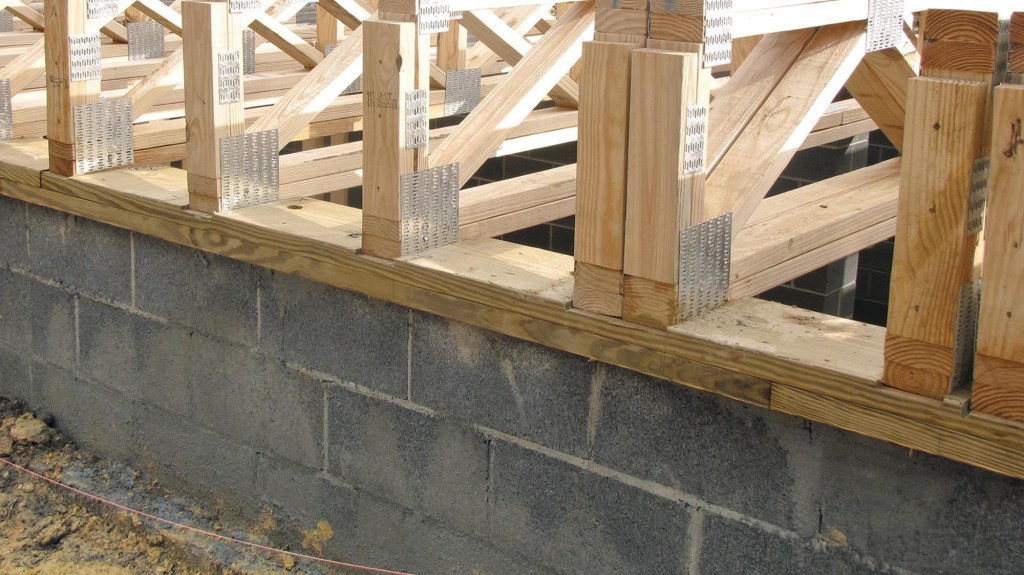

Installing Floor Trusses
Floor trusses are usually spaced 24 in. o.c., and are typically lifted by hand, rolled into place, fastened, and braced.

Bracing Floor Trusses
Bracing prevents trusses from bending, twisting, or otherwise deforming. On bottom-chord-bearing trusses, the ends are tied together with 2x4 ledgers that also serve as a nailing base for the perimeter of the plywood deck (Figure E). Underneath, 2x6 strongbacks laid on edge should run continuously through the webs of all the trusses at 10-ft. intervals (one run for a 20-ft. truss, two runs for longer trusses). The 2x6 serves the same purpose as bridging in a standard floor, distributing concentrated loads over a wider area.
