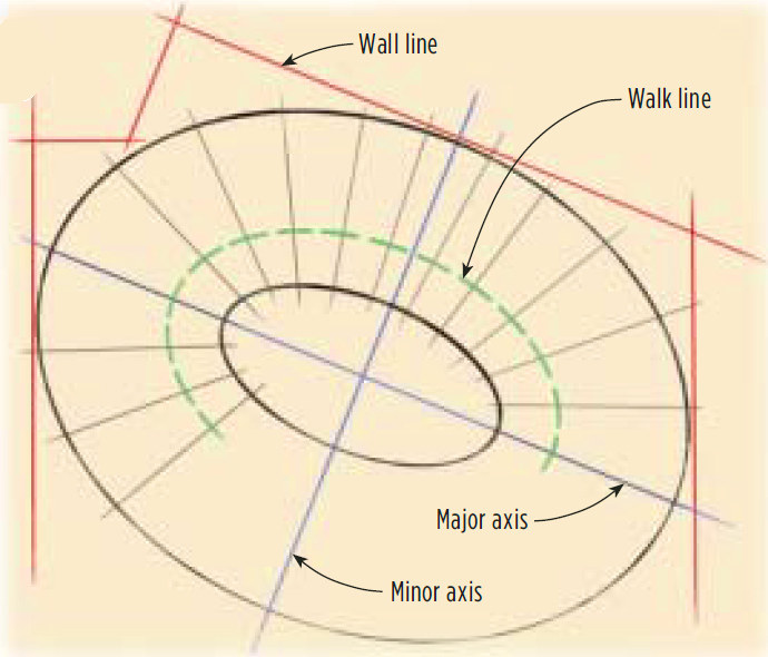

Recently, my friend Nick Ridge and I took on a job in Northern California that had an interesting challenge — an elliptical staircase with a self-supporting inside stringer. To make things trickier, the major axis of the ellipse paralleled a back wall that ran at an angle to the two side walls enclosing the staircase. I had to figure out a way to size the ellipse so that it hit the walls at three unknown tangent points.
The architect's drawing was of little use and I couldn't figure out a way to do the layout with math, so I resorted to the tried-and-true caveman method — trial and error — in hopes of eventually finding the correct-size ellipse to fit the space. Working in an open area elsewhere in the house so that the proliferation of trial lines wouldn't confuse us later, I snapped out the wall layout and started drawing trial ellipses. I got lucky: On the second try, I found the right focus points for drawing the ellipse that fit the space.
After drawing the outside and inside curves of the stair, we did a quick check to make sure the stairs would meet code: First, we drew a third ellipse 12 inches in from the inside edge to define the "line of travel." Using a 50-foot steel tape, we measured the total length along the line of travel and divided by the specified number of treads (11) to make sure the treads were wide enough at that point. The result — 9 5/8 inches — was better than the 9-inch minimum required by the local code.
We used the same procedure to check the tread width along the inside of the curve and came up with 63/16 inches — slightly better than the 6-inch minimum requirement.
Next, we divided the inside and outside ellipses by the number of treads, then snapped lines between the marks to define the treads.

To mark the treads, we positioned sheets of plywood over the floor layout, then redrew the inside and outside elliptical curves using the same focus points as before.
