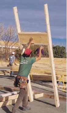

I. Be there before the lumber package is dropped to direct the driver or make sure you have marked clearly where the package is to be dropped. Give yourself enough room to break the package down without crowding yourself, get it close enough to the building that you don’t have to walk too far, but not so close that it’s in your way. The package will usually be stacked for the driver’s convenience, not yours. Most often, the plate material and the floor joists will be under the plywood. While you are snapping lines with one of your helpers, the other two workers should be breaking down the package and sorting it out.
II. Sort out lumber by size into separate stacks. Pay attention to what it’s going to be used for as you do this.
• As you work, cull out unsuitable materials, restack near driveway for lumberyard pickup. At the end of the day, make a list of bad materials to be picked up so they can bring the replacements with them from the yard.
• As you handle each board, crown it now. Make big, visible crown marks with keel, arm’s distance from the ends of the board. This is so you don’t cut the crown mark off, and so you can see it from either end.
• Stack boards with crowns facing the same way. I crown all studs, too, especially 2x6s.
• Stack all materials on stickers 4 feet apart, off the ground. This helps keep the lumber in better shape, makes it easier to handle, and keeps the job site neater.
• After the lumber is sorted, check it against the delivery ticket and the takeoff.

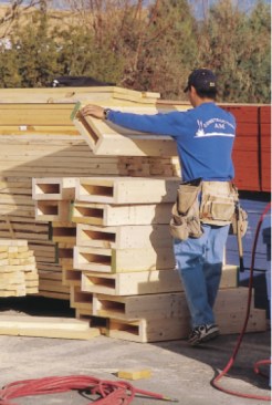

III. Set up a cut station right next to the pile. I prefer a radial arm saw with roller tables on each side.
• Cut all headers. Make a clear crown mark on each header. Write the length with keel as you go. Stack each size separately. We use 4-by header stock on the West Coast. If you’re using 2-by lumber, you’ll want to assemble headers at this point.
• Cut all jacks (trimmers).
• If different lengths, mark them and stack separately.
• If using solid-sawn 4-by header stock, cut all trimmers in place during framing to account for variations in width.
• Cut all sills, mark length as you go.
• Cut all cripples, throw in separate piles as you go.
• Cover anything you aren’t going to use right away — sun is just as bad as rain on lumber.

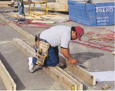

II. Layout. During breakdown, the layout crew should go around and knock all the concrete chunks off the anchor bolts and sweep slab or deck clean.
• Check the slab or deck for elevation, level, and square.
• Check the overall dimensions of all the concrete at this point, too. Make sure they’re the right length and width.
III. Snapping. If it’s all good, square up the slab/deck and snap out all garage walls. If the weather is even a little bit shaky, spray clear lacquer over the lines to keep them in place.
IV. Detailing the plates. Plate and detail the garage. This can be done by the frame crew if they break the package down early.
