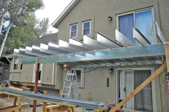

One big advantage steel framing has over wood is that its greate…
One big advantage steel framing has over wood is that its greater spans allow the use of fewer footings.

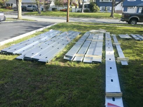

The author buys steel framing members precut to the exact length…
The author buys steel framing members precut to the exact length needed.

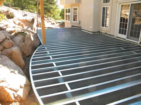

Complex framing can take longer with steel than with wood. For d…
Complex framing can take longer with steel than with wood. For decks like the one pictured above, the steel has to be cut to length on site. Plus, complicated designs have a lot of screwed connections, which take longer than gun-nailed wood connections.

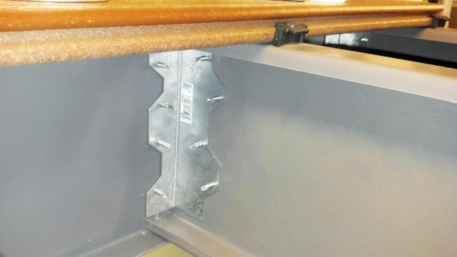

Some steel framing systems require the use of framing hardware t…
Some steel framing systems require the use of framing hardware to make connections.

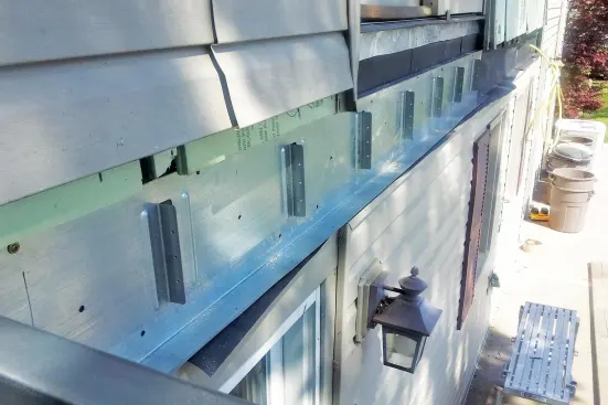

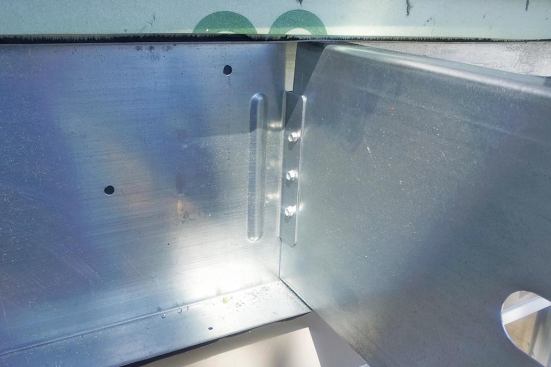

Ledger and rim track is available with tabs punched on standard …
Ledger and rim track is available with tabs punched on standard framing layouts.
Greg DiBernardo
The joists are screwed to these tabs.

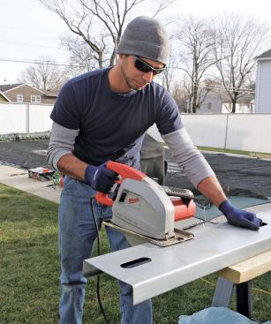

A specialized steel-cutting saw makes quicker work of cuts and d…
A specialized steel-cutting saw makes quicker work of cuts and does a better job containing the hot chips of steel from the cuts.

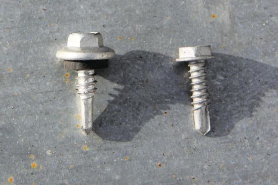

Specialty, hotdipped galvanized, selfdrilling screws are used to…
Specialty, hotdipped galvanized, selfdrilling screws are used to connect steel framing members.
Greg DiBernardo

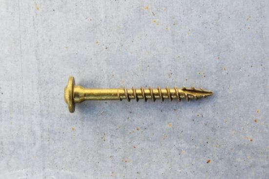

Screws for attaching steel ledgers are shorter than those used w…
Screws for attaching steel ledgers are shorter than those used with wood.

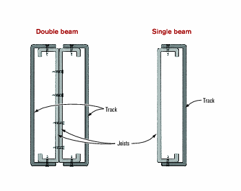

LGS beams are made by joining a joist and a track. A single beam…
LGS beams are made by joining a joist and a track. A single beam (right) consists of one joist and one track, while a double beam (left) consists of two single-beam assemblies.

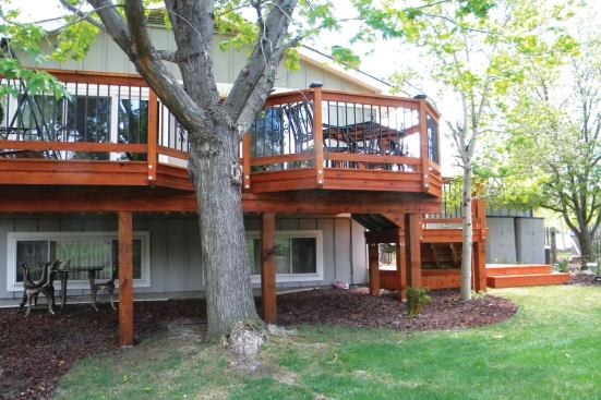

Once everything is wrapped with finish materials, it’s impossi…
Once everything is wrapped with finish materials, it’s impossible to tell what the underlying material is.

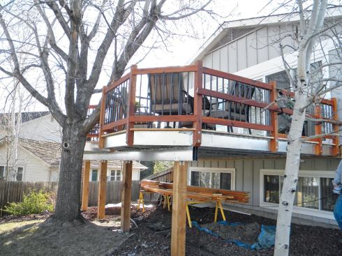

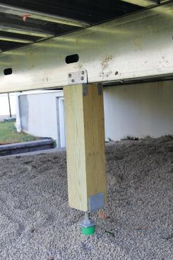

Wood support posts attach to LGS beams with hardware that’s si…
Wood support posts attach to LGS beams with hardware that’s similar to what would be used with wood framing.
Greg DiBernardo

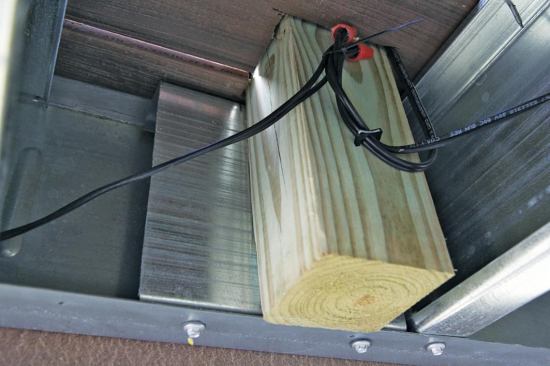

Wood posts are bolted to the steel framing. A short piece of tra…
Wood posts are bolted to the steel framing. A short piece of track between the joist and the post stiffens the joist and provides a rigid mounting surface.
Greg DiBernardo

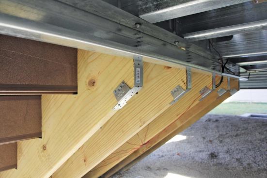

Stair stringers are typically made of wood, which is more econom…
Stair stringers are typically made of wood, which is more economical and easier to wrap with finish materials.

Even better, I’m not handcuffed by the span limitations of wood joists. Steel is able to span mind-blowing distances compared with wood. To stretch the span of wood joists, you might reduce the spacing from 16 inches on-center to 12 inches on-center, jump up to 2×12 framing, or double some members, but there’s only so much that wood allows you to do. On the other hand, to increase a span with LGS, I can change the gauge of the steel, widen the flanges, or change the web depth to suit the design requirements of the project.
For instance, for a rectangular deck that’s 24 feet deep, 16 feet wide, and 11 inches off the ground, I would use 24-foot-long-by-8-inch-deep 16-gauge (54 mil) joists with a 2-inch-wide flange, and space them 16 inches on-center. The 8-inch joists would allow for air circulation below the deck. I would install a single flush beam 24 feet from the house bearing on two footings or, in my case, helical piers. Designing that same deck with wood would require at least one, if not two, midspan flush beams, a plethora of joist hangers, and four times as many footings.
Another huge perk of LGS is that I can order nearly every piece cut to the precise length needed. Not having to cut material on site saves substantial time. My supplier labels every piece of steel with its cut dimension, so assembling a deck frame amounts to pulling material off the pile and installing it in one movement. The only time my crews cut materials on a job is when creating angles or clipped corners, because in those cases it’s easier to run the joists a little long and cut them to length after installation. Using mostly precut framing materials results in essentially zero framing waste, very little clean-up, and reduced debris-removal costs.

Depending on the LGS framing system you use, there may be more cutting, and more framing hardware (such as framing angles) and screws required (Figure 5). An example is the Elevations steel framing system (Trex; 800/289-8739, trex.com). I prefer off-the-shelf LGS framing, mostly because it costs less, but I think Elevations is a good system to use in some special cases or if you’re new to steel framing (see sidebar, below).

To cut LGS framing, you can either use your existing circular saw with a steel blade like the Steel Demon (Freud; 800/334-4107, freudtools.com) or upgrade to a dedicated steel-cutting saw like the Milwaukee 6370-20 (Milwaukee Electric Tool Corp.; 800/729-3878, milwaukeetool.com). My crews built about 10 steel-frame decks using circular saws and they worked pretty well, but upgrading to a dedicated steel-cutting saw was well worth the investment. The new saw captures most of the hot steel filings that otherwise land on the user, and it cuts faster.

All the connections in a steel-frame deck are made using self-tapping screws — typically #10?x?3/4 inch with a 5/16-inch hex head. Sourcing hot-dip galvanized or exterior-rated screws of this size and type can be tricky. Early on, finding screws was probably the most difficult part of building with LGS framing for me and involved a fair amount of frustration as well as trial and error.
The first decent screws I found were Buildex Teks Select screws (Starborn Industries; 800/596-7747, starbornindustries.com). They are distributed for use with Trex Elevations and are readily available online (I buy them through DecksDirect.com). They work adequately with Elevations framing members, which are typically 18-gauge steel. However, I normally use thicker, 16-gauge framing members and prefer HWH 3 KS 12-14?x?3/4-inch screws (Hilti Corp.; 800/879-8000, us.hilti.com) because they have sharper self-drilling tips and install faster. The Hilti screws are slightly more expensive, but it’s money well-spent. You will find that some screws in a box, regardless of the brand, just won’t drill — they spin and spin until the tip burns off. I’ve found this to be less of a problem with the Hilti screws than with other brands.

A steel ledger, or track, installs much like a wood ledger does, and flashing a steel ledger is no different from flashing a wood one. The bolts or screws you are accustomed to using with wood ledgers won’t work, though, because the steel is only about 1/16 inch thick. You’ll need to use shorter fasteners. My crews use 5/16?x?23/4-inch RSS screws (GRK Fasteners; 800/263-0463, grkfasteners.com) to attach steel ledgers. Quarter-inch lag screws may also be used, according to the Trex Elevations design manual. For hollow- or solid-masonry connections, my crews use application-specific Hilti chemical anchoring systems. In any case, you should consult a structural engineer to determine the proper screw and fastening pattern for your load application.
Installing steel joists into a ledger track is easier than installing wood joists with a wood ledger. I order Trade Ready Rims (ClarkDietrich Building Systems; 800/543-7140, clarkdietrich.com) for ledger tracks. They come punched and drilled and have bent tabs for attaching the joists at either 12-inch or 16-inch on-center joist spacing. Installing the joists is fast and precise because no measuring is required. Five screws are used per connection — a single screw through each of the top and bottom track legs into the joist flanges, and three through the tab into the joist.
LGS beams or girders are typically single or double. A single LGS beam is simply a joist with a track nested around it and screwed to it. But because it comprises two pieces of steel, its span is surprisingly long compared with what wood beams can handle. A double steel beam is similar, with the only difference being that two joists are fastened web-to-web prior to track being installed on each joist. Screws are driven through the top and bottom flanges, typically at 12-inch intervals. LGS beams are capable of supporting enormous loads over long spans, so intelligent beam design can reduce the number of footings required.

While you can frame a deck with no wood whatsoever, I’ve found that it’s not cost effective or desirable. I still use 4×4 or 6×6 southern pine MCA-treated lumber for support posts under beams because it is far easier to wrap wood substrates with trim than it is to wrap steel. It’s also much simpler to make footing-to-post and post-to-girder connections with wood posts. The hardware is the same as you’d use framing with wood.
My crews typically use composite-railing kits whose post sleeves cover 4×4 wood structural posts. The posts might cost $3.50 each, whereas a tubular steel post would cost 10 to 15 times that. To stiffen the framing and provide a flat surface where a post will be bolted in place, a 6-inch-long piece of track is screwed to the inside of the joist before the post is mounted.
We cut stair stringers out of southern pine simply for aesthetic purposes. While you can fabricate stairs from steel, it requires closed stringers on both sides, which would prove difficult to wrap using matching composite materials, though they could be painted. I’m not sure I could sell the additional cost of labor, time, and materials to my clients when wood stringers do the job.

For me, the decision to use LGS to frame decks has been a good one. I’m building my decks on stable framing that keeps them looking great long-term, and I have fewer callbacks and more referrals. What more could I ask for?
