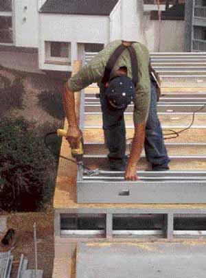

Screwing and Nailing
I use an old 2,500-rpm B&D screw gun with the versa clutch. The clutching action makes this tool somewhat like using an impact wrench. With so many fasteners to drive, it's worth using a corded tool, but for small pick-up jobs I'll use a 12-volt Makita cordless impact driver. Drywallers and commercial steel stud guys like using 4,000-rpm guns, but you'll snap a lot of bits if you release the trigger a split second late.
Areas that will be drywalled or sheathed should be put together with low-profile Phillips head screws. Other connections should be made with hex-head screws, because it's easier to steer and control them with the gun. A variety of screws are available for different steel framing applications, and new ones are being developed every year.
Specialized nails and guns are available for assembling certain parts of LGS buildings. We use nail guns primarily to fasten wall and roof sheathing. Guns and fasteners are also available for attaching drywall, siding, rigid foam, and for certain steel-to-steel connections (such as stud to track). The nails have limited shear values and vary in design depending on the gauge of the stud and the sheathing material.
