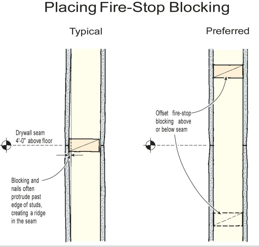

Fire stops at seam height. Installing fire-stop blocking behind a drywall seam sounds like a good idea at first, since the blocks will provide a strong backing. The problem is that if the blocks — or the nails used to attach them — protrude past the edges of the studs, there will be a ridge in the drywall seam. The ridge may appear only in spots along the wall, but it can be difficult to fix. And it's an annoyance homeowners may notice only after they move in and turn on their lamps.
Many framers automatically place fire-stop blocks in wall cavities at drywall-seam height. In fact, the author prefers that the blocks be offset, because they tend to cause ridges in the drywall seams.
Keep fire blocking away from seams. And no matter where you put it, take the time to install it flush.
