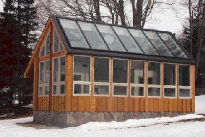

On a recent job, we built a custom, free- standing sunroom using Summit (Jeld-Wen, www.summitwindows.com) vinyl custom picture, awning, and trapezoidal units for the vertical glass, and three motorized Velux venting roof windows on the north-facing roof slope. Automatically controlled by thermostat and rain sensors, the roof windows allow cooler, fresh air to convect up from the low-mounted awning window vents. We also installed a separate, thermostatically activated power vent to further control indoor temperatures. For the array of 3×9-foot fixed glass panels on the south-facing side, we used Pro-Seal glazing bars (Abundant Energy, 800/426-4859, www.abundantenergyinc.com), a versatile glazing system for sloped and vertical applications. Pro-Seal’s glazing bars are made of extruded aluminum in a white or bronze finish and fit various glass thicknesses from 1/4-inch single-pane to 1-inch insulating glass. The bars come in 20-foot lengths, shipped by common carrier, or they can be factory-cut to lengths under 8 feet and shipped by overnight carrier. Since the components are field cut and installed, the shape of the glazing panels can be customized to suit eccentric or irregular openings. Panel size is limited only by the size of glass that can be manufactured.

Pro-Seal is strictly a nonstructural, or “skin,” system and must be fastened to a wood or metal supporting frame. On this frame, we used 4×8 Parallam rafters, lag-bolted over an 8×16 structural Parallam ridge beam. While certain solid lumber species, such as Douglas fir or cedar, may be acceptable, stability is crucial. A wood frame that shrinks, twists, or allows excessive movement will spell big trouble for any glazing system. For this reason, pressure-treated lumber and green lumber are especially poor choices.
On the south-facing side of the building, which is fully glazed, we joined the wall corners and mullion posts to the roof framing with custom-welded 1/2-inch-thick steel moment connectors to resist wind racking. The north-facing walls and roof had conventional framing with enough sheathing to provide sufficient stiffness.
There are no rough openings in a custom sunroom; it’s finish work from the beginning. The upper edge of the sloped framing supports the glazing system and must therefore be as true and square as possible. Headers must be flush at the top with the rafters, and any bumps or crowns must be planed flat. Everything lays out on centerlines; the extruded aluminum bars are a consistent 2 1/2 inches wide and have full-length centerlines inscribed on them to help with alignment.
When we had completed the framing, we covered the rafter tops with a peel-and-stick membrane underlayment to prevent any possible condensation from contacting the wood (Figure 2). At the eaves, we installed custom-bent aluminum apron flashing that runs from the bottom edge of the roof opening over the edge of the roof.
