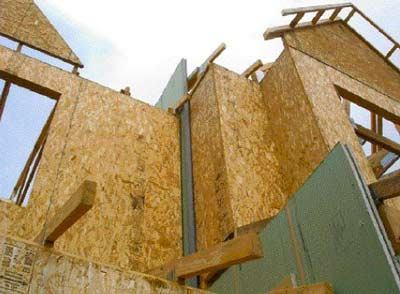

Area separation walls are critical safety features in multifamily housing. If one unit catches on fire, the area separation wall (also known as a firewall or party wall) is designed to prevent the fire from spreading to an adjoining unit or units. Equally important, it must be constructed to allow a burning unit to collapse without pulling down the firewall or compromising its structural integrity. A firewall must be continuous from wall to wall and from foundation to roof. In most cases, it continues through the roof sheathing as a parapet and protrudes through the exterior walls, although other terminations are possible where allowed by code.

We’ve found that the best and most cost-effective solution is to use two-hour­rated gypsum-board area separation walls, which are approved by BOCA — the applicable code in our area of operations — and meet the requirements of our insurance underwriters. (Some townships in our area still require masonry walls, however.)
Gypsum-board area separation walls are a little bit cheaper than masonry, in our experience, but their real benefit is that they’re easily erected by carpenters. Our current crew of framers, for example, had never installed gypsum-board separation walls, but they mastered the procedure within a few hours. With the required trade already on the site and weather conditions removed from the equation (carpenters can work on gypsum-board walls even in the coldest weather), it becomes much easier to stick to the schedule.

The heart of the system is a double layer of 1-inch-thick gypsum liner panels, which fits between the back-to-back framed walls of two adjacent units. The area separation wall begins at foundation level, where a U-shaped metal track is pinned to the slab. Because the gypsum-board panels are so light, they don’t require separate footers.
