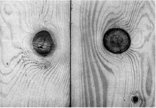

Every builder knows that knots can reduce the strength of a piece of lumber – large ones more so than small ones. Builders are also aware of the premium price of a piece of knot-free lumber.
The effect of a knot on strength depends on the size of the knot relative to the size of the lumber, the location of the knot, and the distribution of loads on the lumber.
Intergrown knots (left) have some capacity to resist stresses, but the wood around them has increased crossgrain, which may weaken the lumber. Encased knots (right) have no capacity to resist stresses and may even fall out, but the lumber around the knot may actually be stronger.

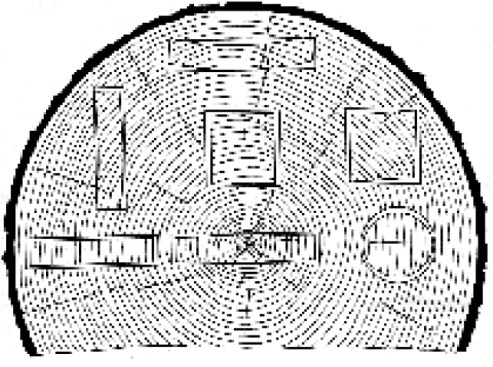

Characteristic shrinkage and distortion of flats, squares, and rounds as affected by the direction of growth rings.

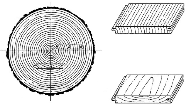

The orientation of the growth rings within a piece of lumber also affects its performance. When the tree is harvested, cut into lumber, and allowed to dry, it begins to shrink. Wood shrinks mostly in the direction of the annual rings (tangentially), about half as much across the annual rings (radially), and only slightly along the grain (longitudinally).
When framing lumber with a moisture content of 15 to 20 percent is installed in a new building, the wood will continue to dry to a lower moisture content – on the order of 10 to 12 percent or lower. As it dries, it shrinks further, which may result in warping, checking, splitting, or other performance problems.
Lumber shrinkage is not new. However, the reduced diameter of the trees being harvested today results in a larger proportion of flat-grained lumber than edge-grained lumber. Flat-grained lumber is more subject to shrinkage and causes such problems as cupping and bowing.
Edge-grained wood shrinks less across the grain and warps less than flat-grained wood.

Knots. Although a knot itself is as strong as the rest of a piece of wood, the area near the knot is weak because of crossgrain. If a piece of lumber is milled when the log is still green, the knot is said to be “tight.” If the growth layer of the tree is dead, however, the know will be loose or fall out when sawn. The number, size, and location of knots influence the strength of structural lumber.
