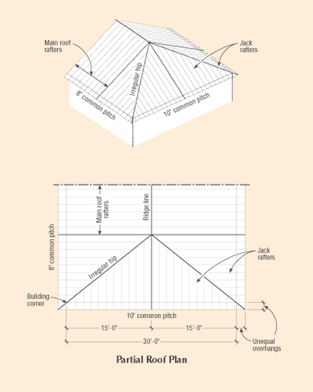

Cutting my first complex roof slowed me to a crawl. Things got especially hairy where two slopes of unequal pitch met in a hip or valley. Although I gradually sorted out the trigonometry that enabled me to move through all the steps and cuts, I’ll admit that mastering the calculator keystrokes wasn’t a piece of cake. Sometimes on site it’s more practical to take a simpler approach. In this article, I’ll show how you can lay out and cut a split-pitch, or irregular, hip rafter using a framing square, a tape measure, a bevel gauge, and a series of triangles you can draw on a scrap of plywood.
As an example, I’ll use a roof where the main 8/12 pitch ends with a 10/12 hip. Because the converging pitches are unequal, the hip doesn’t bisect the plan view at 45 degrees, as it would in a regular hip roof. In a regular 8/12 hip roof, you would use 8/17 to step off the hip rafter; 17 is the unit run of the hip per 12 inches of run of the common rafters. With a split-pitch roof, that won’t work — as a unit run, 17 applies only to a 45-degree hip.
Because the 8/12 pitch in my example is the main roof and establishes the ridge height, I’ll do the hip layout in terms of that side of the roof. This will mean finding a new ratio that expresses the 10/12 pitch in terms of an 8-inch rise.
In all the drawings, layout will be done at the centerline of the framing member; you would need to deduct for the thickness of the stock before you cut.
Find the Hip Angle in Plan
The hip doesn’t hit the wall at 45 degrees, but finding the angle is easy. Using the framing square, draw a right triangle with a 10-inch and an 8-inch side. Close the right angle with the hypotenuse and you’ve got the angle of the hip in plan, plus the two cheek-cut angles (triangle A).
The irregular hip plan angle is a straightforward representation of the relationship between the two roof pitches, in this case 8 and 10 inches, drawn as two sides of a right triangle. The 8-in-12 slope is the “main,” or controlling, pitch on this roof; the 10-pitch is subordinate. The resulting angles can be copied with a bevel square and used to set a circular saw for the hip cheek cuts.
