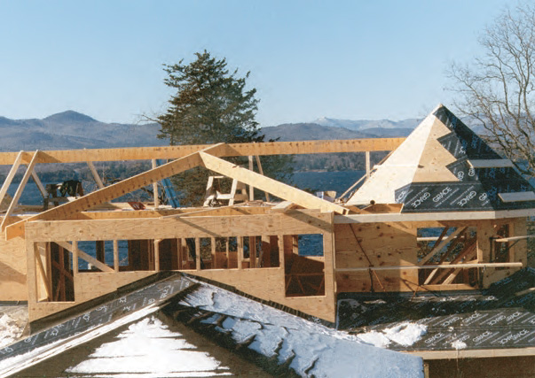

On a recent new house with some 26 different roof planes, our crew got lots of practice joining unequally pitched roofs. By the end of the job, we had settled on an accurate, efficient method for figuring the cuts on irregular hip and valley rafters. In this article, I’ll focus on a section of the roof where a lower bumpout with a 4 3/4:12 pitch met the higher 6 1/2:12 main roof. We framed this section of the roof with a major (or supporting) valley rafter — a doubled LVL that extends all the way to the structural ridge and supports the minor valley, which intersects it lower down.

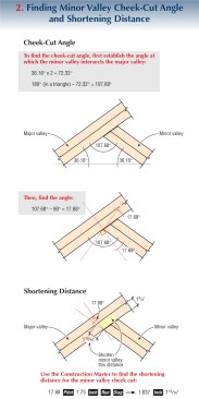

The process is similar for finding the length of the minor valley, except that I enter the run of the bumpout roof, 11 feet, in the Construction Master. This means the bumpout’s roof slope is now the “pitch,” while the steeper main roof is the “irregular pitch.” Again, the soffit is added in, but it’s easier to subtract half the thickness of the supporting valley just before making the cut. (See illustration 2 for a simple way to find this shortening distance as well as the cheek-cut angle for the minor valley.)

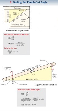

Finding the Plumb Angle & Birdsmouth Layout
Now it’s time to lay out the plumb cuts at the ridge and birdsmouth (see illustration 3). For this, I reach for my trig calculator again. First I have to figure the true run of the valley rafter (as opposed to the main roof run). To do this, I divide the main roof run (167 1/8 inches) by the sine of the angle in plan (sine of 36.16 degrees = .59), yielding 283 1/4 inches. Then I solve for the cosine of the angle where the valley meets the top plate by dividing the run of the valley by its length. The angle turns out to be 17.73 degrees — the plumb-cut angle.
The seat-cut angle is simply the complement of this plumb angle, 72.27 degrees.
Now I can make the plumb cut at the top of the valley, setting my saw shoe at a 36-degree angle, as calculated above. To actually locate the birdsmouth, I use the same process as for finding the length of the valley, except this time I subtract out the overhang to get the length to the outside of the top plate. This gives me the distance from the ridge cut to the plumb cut on the birdsmouth.
The height of the birdsmouth is the same as on all the common rafters, although the length of the seat cut will be longer. Remember that this layout is made at the centerline of the doubled rafter and that the birdsmouth plumb cut is also angled at 36.16 degrees to match the angle of the top plumb cut.

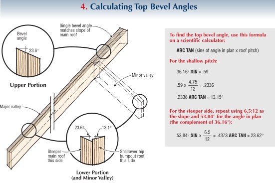

Finding the Top Bevel Angles
Both the minor valley rafter and the lower portion of the major valley rafter need two bevel angles, to plane into the pitches of the steeper and shallower intersecting roofs. But the section of the major valley that extends past the intersection with the minor valley has only a single bevel angle, to match the slope of the main roof (see illustration 4, below).
I find it’s easiest to figure the top rip angle using a trig-function calculator. For any hip between two roofs, the top-rip angle will be given by the formula:
arc tan (sine of the angle in plan of valley x pitch of roof)
This calculation must be done twice — once using the shallower pitch, with a plan angle of 36.16 degrees, and again using the steeper pitch and a plan angle of 53.84 degrees (the complement). In each case, the angle I derive with these formulas is the angle at which I set my saw table. I rip this angle with my saw table on the face of the board, with the blade following the corner along the edge. At the point where the minor valley intersects, the bevel angle on the shallow-side member reverses to match the steeper angle of the main roof.

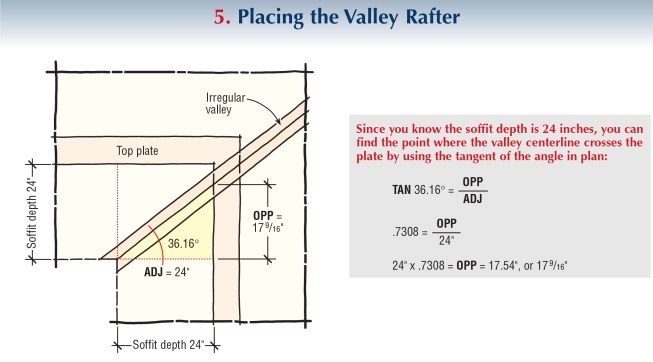

It’s helpful to know exactly where the irregular valley crosses the top plate, since it’s not at the corner. Often, I’ll use the angle in plan of the valley and find this working off the scaled plans. You can also figure it with some simple trig, as shown in illustration 5, above.
