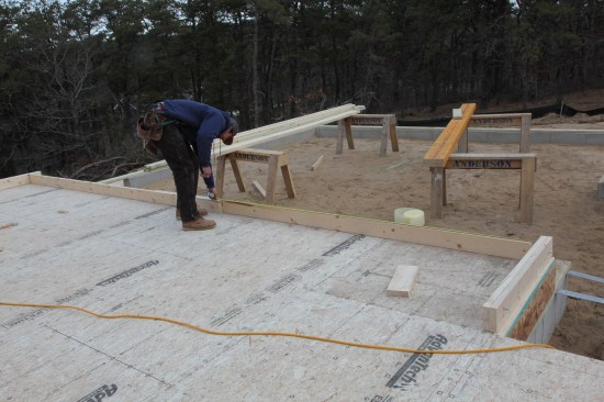

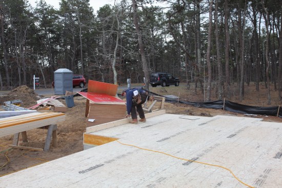

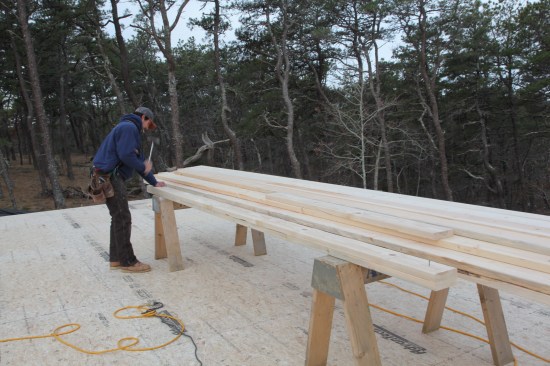

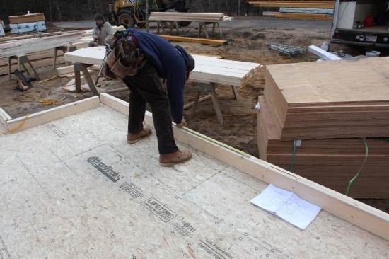

The first task was setting up a cutting station for the plates. For that purpose, two heavy-duty sawhorses were set up in a central but out-of-the-way location on the first-floor deck. A lift of 16-foot 2x6s labeled “plates” had come from the lumberyard, and the crew loaded a few dozen of those boards onto the sawhorses. As they went through the pile, they set aside warped or twisted boards, keeping only the straightest boards to use as plate stock.

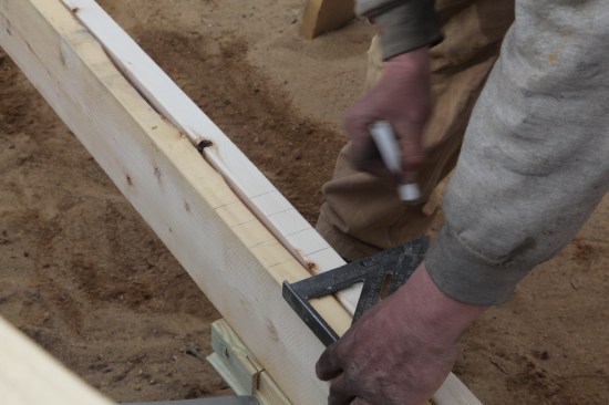

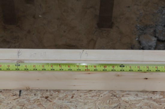

Before plates are measured and cut to length, one end is cut square. Measurement is then taken from that end.
Square the Stock and Cut to Length

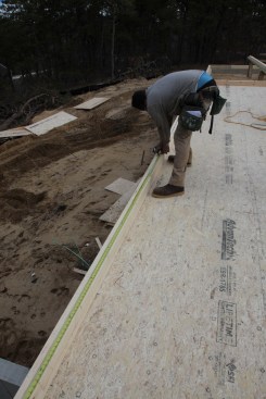

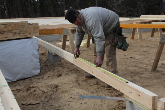

Once the stock is loaded and ready to go, two crew members start laying out plates on opposite sides of the house (to stay out of each other’s way). They take measurements directly from the wall layout before measuring and cutting the plates to length.

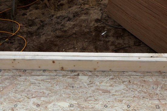

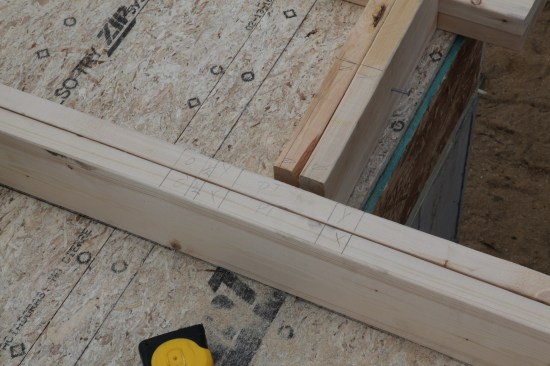

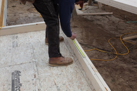

When the walls are shorter than the plate stock on site, the plates are measured and cut in pairs. After they are cut to length, the two boards are tacked together.

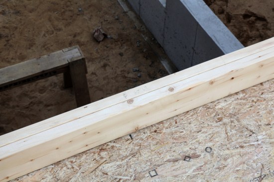

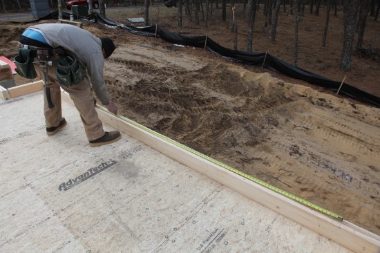

After the boards are tacked together, the pair is set in place on the perimeter of the deck where the wall will be built.

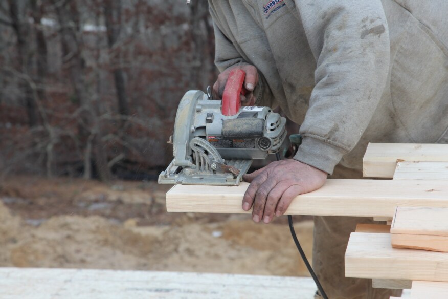

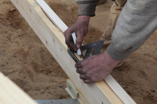

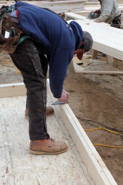

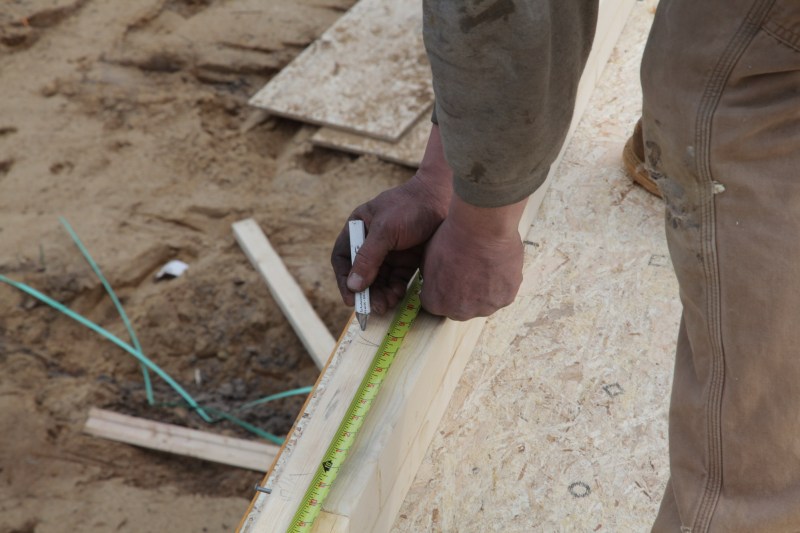

Framing stock rarely comes from the supplier with perfectly square ends, so we always saw one end of the board square before we cut it to length. We pull our measurement from the squared end and cut the plates to length. If the length of the plate is less than the length of the stock, two plates (top and bottom for the wall) are cut and tacked together at each end. We then place the paired plates on the deck where the wall will be built.
When the wall is longer than the plate stock, both ends are squared on two lengths—one for the top plate and one for the bottom. The boards are then set in place with one end of each board set on the layout line and the two boards overlapping in the middle. The boards are tacked together at the overlap.
Next, a measurement is taken from the end of each board to the overlap to obtain the lengths for the boards that will fill in the rest of the top and bottom plates. Those boards are then cut and tacked in place.
If the wall is longer than the plate stock we’ve been given, we square both ends of two lengths of stock—one for the top plate and one for the bottom plate—and then set the boards in place with one end of each board at an end of the wall and the other ends overlapping in the middle. After aligning the ends exactly on the layout lines, we tack the two pieces together at the overlap. Then it’s just a matter of measuring from each end to the overlap and cutting the fill-in pieces to complete both plates. We use a second top plate, so we never try to break the plates exactly over a stud. In fact, I’ve been told that nailing the ends of two plate sections to the same stud can create a weak point in the framing.

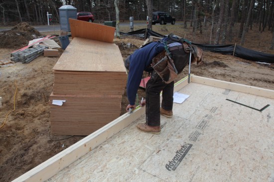

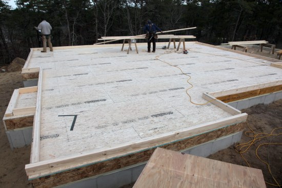

Plate measuring and cutting proceeds until all the wall plates are cut and set into place.
We usually don’t start the actual layout until all the plates are cut and set in place around the perimeter of the deck. To keep the framing consistent throughout the house, we always pull layouts from the same point. This keeps the framing members aligned for direct load transfer from the rafters all the way to the mudsills. For this house, we used the side of the house opposite the garage and the back wall of the house as starting points for the layout.

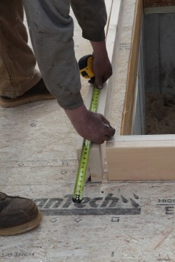

The openings for doors and windows are the first items to be laid out. Close attention must be paid to exactly what the dimensions on the plans refer to. Sometimes they denote the distance to the centerline of opening, and other times the measurements on the plans are to the center of an architectural element of the house. For example, the dining-room slider on the rear of this house was centered on a screened porch. An open deck next to the porch became the centering element for a double kitchen window. Dimensions given on the plans were for the porch and the deck with indications that the openings be centered on those elements.
The first things the layout crew marks on the plates are the openings. Here the crew member measures to the middle of the wall, which is  the middle of a center window.

The carpenter doing the layout also writes the R.O. dimensions either next to the centerline or in some conspicuous place within the opening. These dimensions correspond to the list of headers, cripples, and jacks that the rest of the crew is working from. When we’re ready to “load” the lumber for each wall, we can just go to the various piles and grab the framing member that has the same dimensions that are written on the plate.
After the openings are laid out, the rough opening measurements are written on the plates in the opening to help facilitate wall building later.

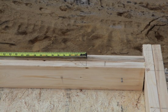

For the walls that begin at the edge of the floor deck, stud layout is easy—just hook your tape on the end of the plates and go. The walls that start inside another wall are a bit trickier. The layout still starts at the edge of the deck, but the end of the wall is the width of a 2×6 away. For those walls, we line up the 5 1/2-inch mark with the end of the plates and mark out the first stud location. We drive a nail at that point and then hook the tape on the nail to pull the layout, remembering that the layout is now marked at the highlighted 16-inch-on-center marks on the tape, and not 3/4 inch away as before.
For walls that attach inside other walls, stud layout is a little different. Layout for the first stud is marked by holding the 5 1/2 inch mark on the end of the plates. A nail is then driven at the layout mark and the tape is hooked on the nail.
With the measuring tape hooked on the nail, the studs are marked out along the plate—this time with the layout crew marking directly on the highlighted tape measurements instead of deducting 3/4 inch.
