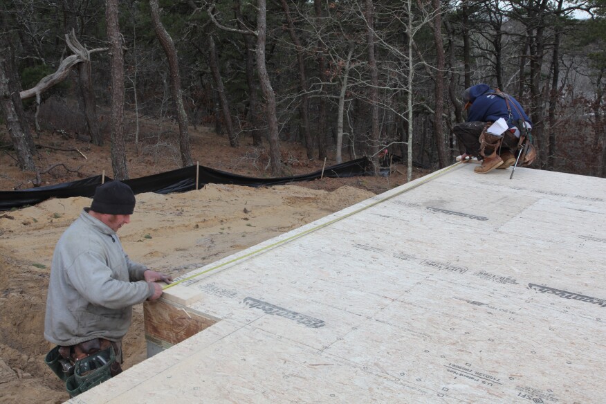

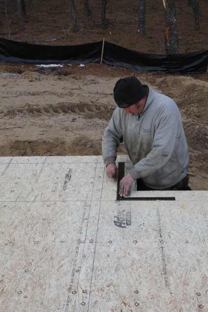

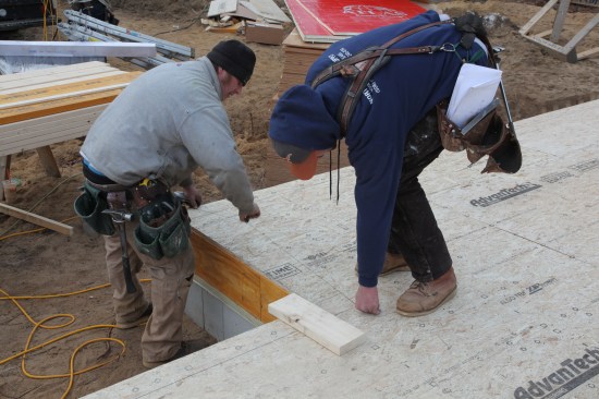

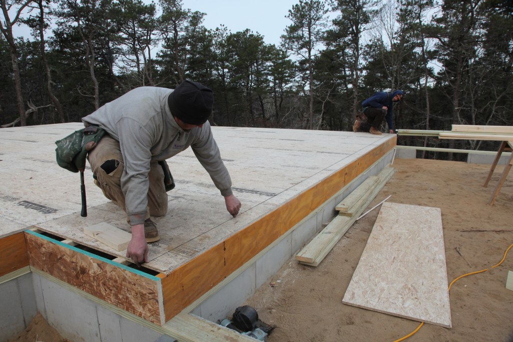

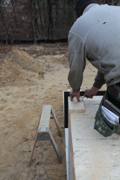

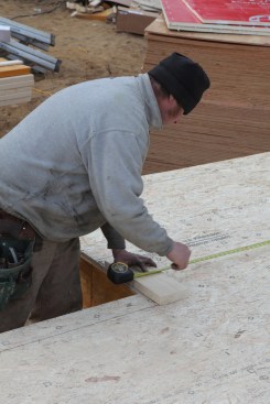

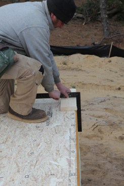

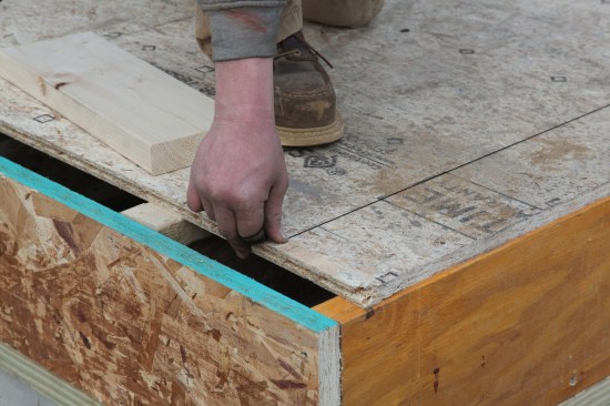

The first layout task is to establish a base line or reference line for locating the rest of the layout lines. Here the lead carpenter uses a layout block made from plate stock and a framing square to align the layout with the deck framing.
Using the same technique, the other side of the corner is marked. This process is repeated at the opposite end of the longest wall of the house to establish the corners of the baseline.

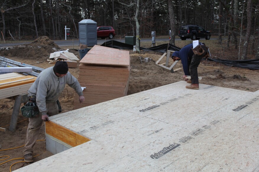

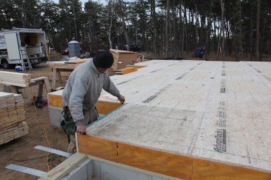

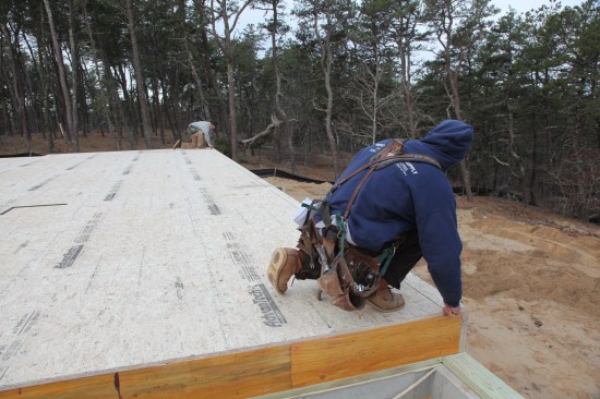

The end wall that the house shares with the garage is uninterrupted, while the wall at the opposite end of the house jogs in slightly and continues uninterrupted except for a small fireplace bump-out.

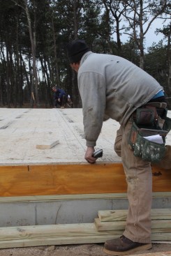

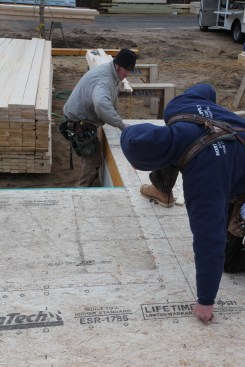

Measured off the baseline, the next corner is laid out. The position of this corner will be finalized during the squaring process.

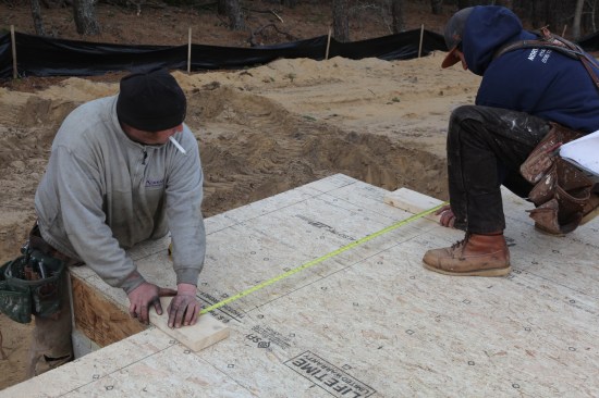

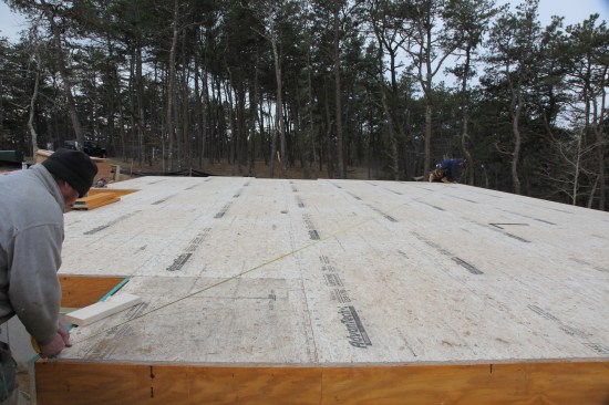

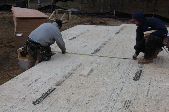

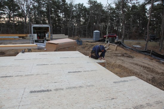

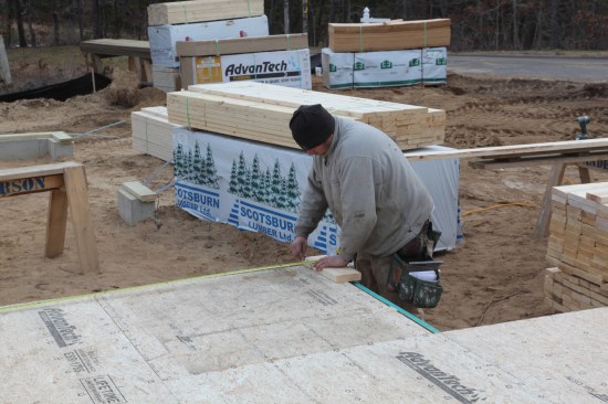

The first thing we do in the layout process is mark the inside edge of the longest exterior wall—in this case, the back wall of the house. We cut layout blocks out of 2×6 plate stock about 16 inches long. Then, using a framing square, we line up the block with the rim joist to make sure that the block is perfectly in line with the deck framing. We mark both sides of the corners at either end of the wall. This first wall is the baseline, or reference, for laying out the rest of the walls on the deck.

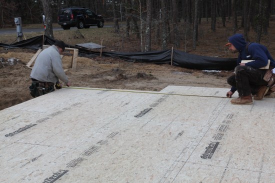

Here, a crew member measures the exact length of the baseline wall.

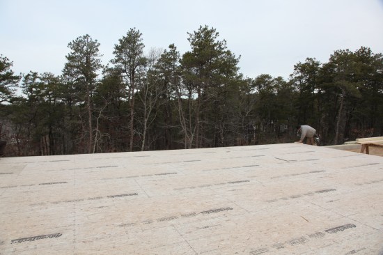

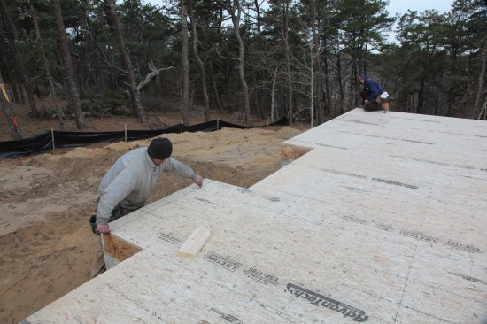

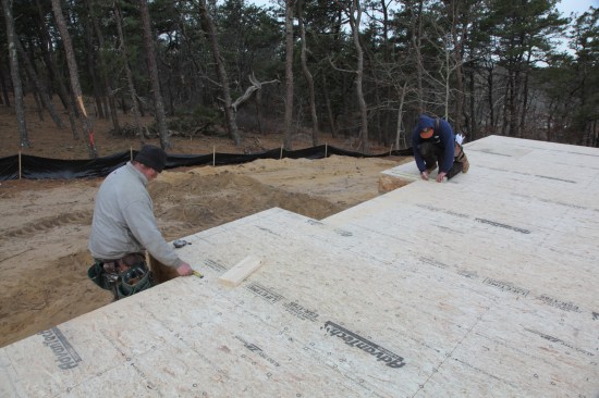

Next, we mark out the other corners of the house. For most houses, we usually just go around with the 2-by block, mark the other corners, and then check diagonal measurements. But because of the jogs in this house, we altered our strategy slightly.
Measuring over the length of the baseline wall and measuring up the length of the opposite wall from the baseline, a crew member marks the last corner for the largest rectangle on the deck. This corner fell in the framing for a bump-out fireplace.

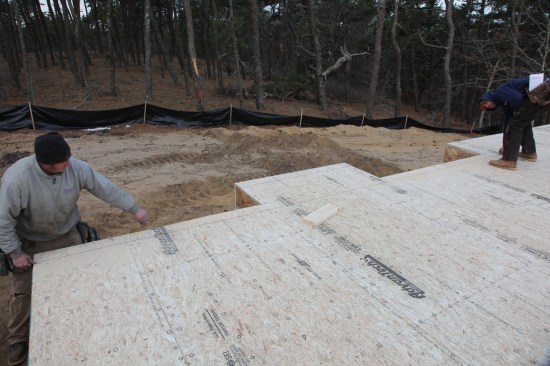

We started by marking the corner of the first jog. Holding the block at the overall length of the end wall shared by the garage, we again marked along the inside edge of the block. As before, we also marked the other side of that corner.
At the opposite end of the house, we measured up from the baseline and marked the same distance. Because of the jog on that end of the house, that measurement actually fell in the fireplace bump-out. After determining the exact length of our baseline wall, we measured over that distance from the first jog to create a second “corner,” again using our block to make the marks.

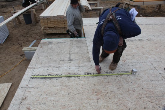

Next, the crew makes diagonal measurements between the corners of the rectangle and adjusts their positions until the measurements are exactly the same. Those adjusted corners locate the end walls precisely perpendicular to the baseline wall.
Those corners along with the baseline corners gave us the largest rectangle on the deck to check for square. Measuring diagonally from corner to corner, we adjusted the positions of our second set of corners until the diagonal measurements were exactly the same. In this case, the positions shifted toward the garage about 1/4 inch,
which is well within expectations for a typical deck frame. These adjusted marks positioned the perpendicular walls so that they would be absolutely square to the back wall of the house.
