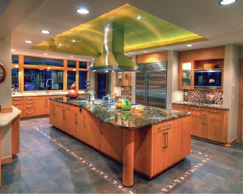

The owners of the 1970s home shown here liked to cook and entertain, but they were continually frustrated by a cramped floor plan. The original kitchen was tucked into a niche at the back of the house and felt cut off from other rooms. When they contacted our design-build remodeling company, the owners had no specific ideas in mind; they just knew they wanted a larger kitchen that connected with the spaces around it and included design features that would draw guests into the room — a “wow” factor, as they called it.
In response, our in-house architect came up with a plan that involved building an addition off the back of the house and relocating the laundry room to another area. The existing kitchen was around 200 square feet; we would be adding another 360 square feet and wanted to do something to make the area special. In many kitchens, the island is the centerpiece of the room, so we decided to create a complementary focal point on the ceiling above. Since we had been in the attic and knew there was space to expand vertically, we suggested building an uplit barrel vault centered over the island. The owners liked the idea because it took what would have been a large, low ceiling and turned it into a conversation piece.
One end of the vault would be in the roof of the addition; that was new construction, so we were confident it would be easy to frame. The tricky part would be framing the section of the vault within the existing footprint, because the roof above was framed with trusses.
We asked the manufacturers supplying trusses for the addition what they would do to create space for a vault within the existing roof. They suggested replacing the existing trusses with new ones that were raised in the middle. We rejected this idea because it would have required that we remove a large area of clay tile roof and demolish the ceilings in adjacent rooms — work that would have added about $25,000 to the cost of the job. It would be less expensive for the clients and less destructive to their home if we could create the necessary space within the existing trusses.

Demolition came first. To avoid having the blown cellulose insulation fall down on us, we hired an insulation company to vacuum out the old insulation using the same equipment they would use to blow it in. We then removed the ceiling drywall and began the structural work.
Our first step was to install an 8x6 tubular steel beam against the bottom of the trusses at the opening between the kitchen and family room. We supported the beam on a pair of 5 1/8-inch glulam posts that ran to the foundation below, bolting it in place. This beam would support one of the new bearing points in the altered trusses; the other support, the garage wall, was already in place.
