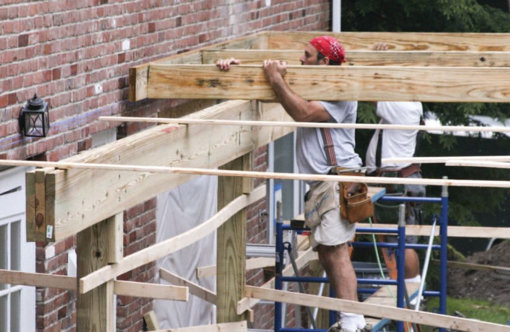

Carpenters set the joists for a freestanding deck; the band will remain spaced away from the brick veneer wall.
