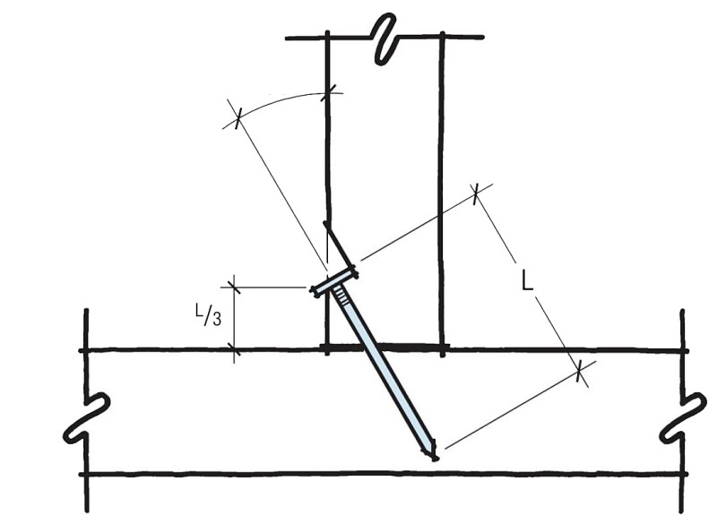

Q: My crew often has questions about nailing studs when we build walls. For starters, the code is specific about the number and size of nails for end-nailing wall plates to studs but doesn’t specify the size of the studs. Do the same number of nails apply for 2x4 and 2x6 studs? How about for 2x8s in fat walls? Also, what’s the correct angle for toenailing studs to plates? Is the goal to drive the nail through the center of the end of the stud or near the far corner

Place toenails away from the end of the board a distance that’s equal to one-third the length of the nail. Angle the nail so it comes through at the center of the board’s thickness. This angle is less than 45 degrees.
Tim Healey Proper toenailing. When toenailing, place the nail away from the end of the board at a distance that’s equal to one-third the length of the nail. With a 2 1/2-inch nail (such as an 8d sinker), start 7/8 to 3/4 inch up from the end and drive it at around a 45-degree angle to exit the center of the stud section. A longer nail (as shown above) would be driven at a steeper angle to exit the center of the stud.
For the question on toenailing, a nail driven at an angle coming out the bottom of the stud close to its center will provide the strongest connection. This is what the American Wood Council tests to determine the strength of toenail connections in the National Design Specification. Nails that exit the far corner may not penetrate the plate deep enough to provide sufficient holding power.
My personal preference for toenails is hand-nailing with 8d sinkers (2 1/2-in. x 0.113-in.). I find they are the easiest to place and start for a roughly 45-degree exit at the center. (The angle would need to be steeper with a longer nail, as shown in the illustration, below). Practice makes perfect for speed and accuracy.
