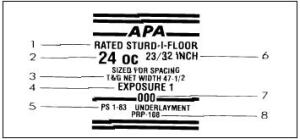

Q. Can painted plywood be used as both the subfloor and finish floor over 24-inch on-center joists? What thickness would the plywood need to be? Would I need two layers?
A.Clayton DeKorne responds: According to Tom Kositsky, a technical representative for the American Plywood Association, you would not need two layers of plywood for any structural purpose, as long as you use APA-trademarked Sturd-I-Floor panels with a 24-inch on-center span rating. (A complete explanation of the APA ratings, and guidelines for the use and installation of plywood, can be found in the APA’s Residential and Commercial Design and Construction Guide. Single copies are available free from the APA, 7011 S. 19th St. W., Tacoma, WA 98466; 206/565-6600).
Sturd-I-Floor-rated panels are designed as combination subfloor and underlayment panels, usually intended to go under a carpet and pad. In general, a panel intended for use as “subfloor” is designed as a structural member, with a span rating (such as 16, 20, or 24 inches on-center) that is clearly marked on the grade stamp (see illustration, above). For subfloor, the panel plies are sized (not too thin) and selected from wood species with sufficient strength in bending and deflection. By contrast, a panel specifically designated as “underlayment” has a concentrated core (few voids), so it can sustain impact loads (say, from a couch dropped by the movers) and point loads (the weight of a person wearing high-heeled shoes, for example). As a combination panel, Sturd-I-Floor is designed to meet the different strength requirements for both these applications.
