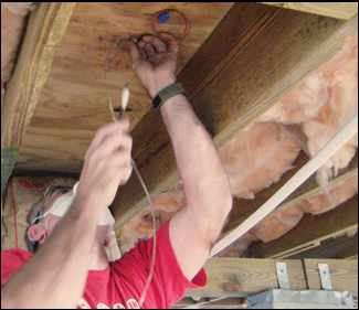

Charlie Carll, Research Forest Products Technologist at the U.S. Forest Products Laboratory, attaches temperature and humidity sensors to the underside of a floor system at Musicians’ Village in the Lower 9th Ward of New Orleans. Researchers have begun a year-long effort at the community to document the performance of various insulation and air-sealing methods in raised floor construction.

The houses, built by Habitat for Humanity to house musicians displaced by Hurricane Katrina, sit on pier foundations and were originally insulated with fiberglass batts between the floor joists (Figure 7). Now, researchers led by FPL scientist Sam Glass are removing the fiberglass and installing moisture sensors and thermometers in the floor frame cavities, as well as in the space beneath the floors and in the yards next to the houses. They’re also placing temperature and moisture sensors in the house living space to monitor indoor conditions. Then, contractors will install four different insulation and vapor barrier systems under the floor (Figure 8), and the scientists will use data-loggers and field observations to record how the floor systems and the home interiors behave for 12 months.
