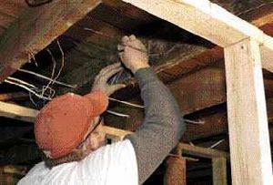

Cutting in the Beam Pocket
Next, we marked the location of the new beam on the floor joists, centering it on the old bearing wall. The beam actually measured almost 7 1/2 inches wide, plus I added an extra 1/8 inch for wiggle room, so we marked a 7 5/8-inch-wide channel to receive the beam.
To get clean, straight cuts, we started our kerfs with a circular saw and finished up with a reciprocating saw. Even though a cut line that wandered 1/4 to 1/2 inch wouldn’t be a big problem structurally, square cuts look more professional, and they help justify the invoice later on.
After cutting the pocket, we cleaned up stray nails to make room for the beam. We were careful to cut all metal flush with the recip saw so that the beam wouldn’t push up the subfloor or finish floor when it was installed. And to accommodate a few stray telephone wires, we cut out a short section of the 1×6 subfloor to leave a 3/4-inch-thick chase above the beam.
