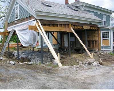

A Plan for Supporting the Roof
How to hold up the second story while building the new foundation underneath was the big question. We first considered using steel I-beams supported on timbers stacked outside the foundation area. We abandoned this idea when the excavator pointed out how massively tall the cribs would have to be; plus, we knew they would be a pain to work around. We also thought about removing and replacing the foundation in short sections, working our way around the perimeter, but rejected this as too time-consuming.
Then, in a meeting with the excavator and concrete sub, we came up with a plan: We would first reinforce the second floor with a grid of LVL beams supported by steel columns; next, remove the framing and stone foundation; then form and pour a new footing and foundation, encapsulating the steel posts in the concrete.
We calculated the approximate weight of the roof and floor — the dead load we’d have to support while the new foundation was built — and had the lumberyard size the LVLs we would use. The idea was to carry all the second-floor loads to the exterior walls and from there to the ground with as few posts as possible. With no temporary shoring to work around in the middle of the ell, the excavator would have an easier time digging out the crawlspace. After the new foundation was placed, we would frame new walls and cut off the steel columns at the level of the rim joist. The LVL grid would remain in place to support the new ceiling and would also serve to reinforce the sagging joists above.

Inserting the Steel Columns
We used seven 4-inch-by-4-inch steel columns in all, each with a 30,000-pound capacity, to pick up the weight of the roof and second-floor framing. We worked our way from bearing point to bearing point, removing just enough studs to give us room to cut out the sill and excavate for a post footing. At 12 feet, the columns were long enough that we could place the 6-inch-thick, 16-inch-diameter precast concrete footings below the bottom of the eventual stem-wall footings. We placed a column under each end of the 14-inch LVL beam, one at each outside corner and the rest at intermediate locations. With the exception of the gable-end support, we placed the columns within the stud cavities so we could form and pour the footings and foundation around them.

The columns had 6-inch-by-6-inch-by-1/2-inch-thick steel plates welded to each end. As we installed each column, we used 2-by blocking and LVL cutoffs as necessary between the column’s top plate and the bearing point on the LVL to ensure full support. With the steel posts in place, we removed the rest of the wall framing and the stone foundation and set about getting the old slab out of the way.

Nothing goes exactly as planned in remodeling work. We knew that there was a buried cistern just outside the existing stone foundation, and our plan was to remove it and fill in that area. Unfortunately, we soon discovered that the cistern — a stubborn structure of reinforced concrete — was attached to the main house foundation and connected to another cistern inside the crawlspace. We had no choice but to jackhammer the obstruction — an unexpected task that added about 60 percent to the budgeted excavation cost. The rest of the concrete was removed with the excavator.
