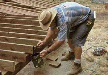

Millions of wood decks are built every year. Unfortunately, many of them will deteriorate long before they should. As a deck builder in the Pacific Northwest, I have a lot of experience demolishing and replacing rotted decks. I want what I build to last, so when I tear down a rotting deck, I try to figure out what went wrong.

A typical deck harbors hundreds of places where organic matter can collect and sit. I call them collection zones. Every time it rains or the wind blows, leaf litter — leaves, needles, twigs, dirt, dust, and grass clippings — finds its way into the gaps and cracks in the deck. The collected material holds moisture, so that a deck full of collection zones mimics the natural habitat of fungus — wet fallen wood on a forest floor.
A collection zone can be very small. For example, when a baluster is nailed to the face of a rim joist, the area where the two pieces meet is a collection zone. Poor deck design and building practices increase the size and number of these zones. Once the collected material becomes wet, rot will attack any unpreserved wood in the area.
The best way to prevent this is by limiting the size and number of the collection zones. If you prevent moisture and debris from getting into places they can’t get out of, you reduce the potential for rot.
Fascia detail. Some common building practices create perfect collection zones. For example, many carpenters rim the deck with a fascia board. There is usually no airflow between the fascia and the framing, so the 20 percent moisture content required for rot can be maintained over long periods of time. Water takes debris down between the fascia and the rim joist. Once organic matter gets into this collection zone, there is no way to get it out.
It’s best not to use a fascia at all, but if one is required, cantilever the deck boards one inch over it. This detail greatly decreases the likelihood of rot because it reduces the size of the areas that dirt and moisture can get into. One way to compare construction details is by looking at how many linear feet of collection zone each design creates.
Built-up beams. It’s common practice to double or triple up 2-by material to form beams. Unfortunately, the space between the pieces is a perfect collection zone. It’s better to carry loads with solid 4-by or 6-by beams.
