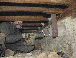

A single-story 1,000-square-foot house weighs about 50,000 pounds. When that much weight rocks back and forth on top of cripple walls, the cripple walls readily collapse.
Our goal in retrofitting a house is to connect it firmly to the foundation and stiffen the cripple walls by turning all or part of them into shear walls. That way, when an earthquake occurs, the lateral forces are transferred through the shear walls into the foundation.
Shear walls. In a wood-framed house, a shear wall is a studwall that’s connected to the foundation with anchor bolts, sheathed with plywood fastened in a tight nailing pattern, and tied to the floor above with shear transfer ties. All three components — foundation bolts, plywood sheathing, and shear transfer ties — must be there for the retrofit to work. If overturning forces are expected — or if the shear wall is tall relative to its width — hold-downs are added to this list.
The mudsill and bottom plate can be bolted to the foundation, but if the cripple walls aren’t sheathed with plywood, the walls can fail. The bolts and plywood can both be in place, but if the floor isn’t properly connected to the wall with shear transfer ties, it may slide sideways in a large earthquake.

Based on our calculations, the house in our example will be attacked by 13,000 pounds of earthquake force in each direction. Retrofitting it will require the following actions.
Anchor bolts. To strengthen the connection between mudsill and foundation, we install anchor bolts. If a bolt is rated to resist 1,000 pounds of shear (its shear value), then we know it will take 13 bolts to protect the house in the north-south direction and 13 to protect it east-west. The bolts should be divided between opposing sides. Since you can’t install half a bolt, we would round up to 14 and install seven bolts on each side of the foundation wall.
Shear transfer ties. The same method is used to calculate the number of shear transfer ties needed to attach joists to the top plate of the cripple wall. We typically use Simpson H10R ties for this connection. Their shear value is shown in the column labeled 1.33/1.60 in the Simpson Strong-Tie catalog (www.strongtie.com). This particular column refers to short-duration lateral loads caused by wind and earthquakes. The H10R ties resist about 500 pounds of lateral force, so we would need 26 in each direction, or 13 per wall.
Plywood bracing. To brace the cripple walls, we typically sheath them with plywood from inside the crawlspace. If the shear-wall configuration (plywood and nailing pattern) is rated to resist 500 pounds plf, then we need 26 lineal feet of plywood on the east-west and north-south walls. Since this bracing is divided between opposing walls, each side gets 13 feet of plywood.
If the calculations showed net uplift from the overturning force, we would install a hold-down at each end of all shear walls. The strength of the hold-down is rarely an issue. The weak link is usually the old unreinforced concrete foundation; if the uplift force is large enough (more than 2,000 pounds) it may pull out the retrofit hold-down bolt, rendering it useless. One solution — an expensive one — is to shore up the building and replace that section of foundation, but it’s often simpler to pour a new footing beside the old one and install the hold-downs in it.
Anchor-bolt spacing. It’s a common mistake to space new anchor bolts evenly around the building. That approach is fine when joists land on the mudsill, but when you turn a cripple wall into a shear wall, those bolts need to be installed where the plywood panels are. We install them every 2 feet at shear-wall locations. The shear transfer ties can be anywhere along the wall; we install them near the plywood because we’re already working there.
