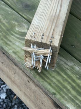

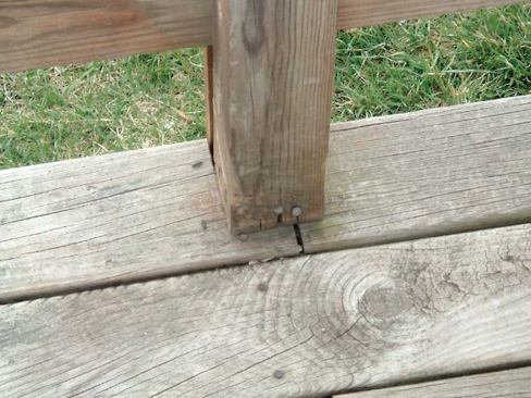

Researchers at Virginia Tech applied measured loads to deck posts to see which connections could meet code. The tests were spawned in part by one author’s observations of dangerously weak details on existing decks, as in the two examples below, where railing posts were simply toenailed into the decking. The post in the bottom photo was covered by a decorative plastic cover, which concealed the flimsy connection.
The point was brought home to us when Frank was asked to inspect the railing on a friend’s deck and found the rail posts toenailed into the decking, an unacceptably flimsy connection. Looking around our area of Virginia, we spotted other railing connections that made it clear that some deck builders, at least, aren’t aware of code requirements for deck railings.

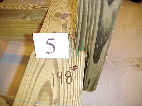

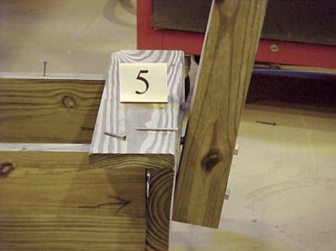

The authors first tested two post connections found commonly in their area, one where the 4×4 pressure-treated post is notched and lag-screwed to the band joist, and a second where the post is through-bolted to the deck band joist. Code requires that a rail post be able to withstand a 200-pound force applied in any direction. The researchers tested the worse-case scenario only, by pulling outward at the top of the post; they applied a 2.5-times safety factor, according to code-accepted test protocol.

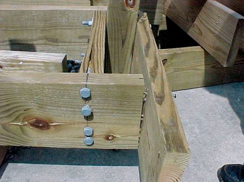

Cracks will typically develop from the corner of a notch (photo, right). As a crack develops, a steep “slope of grain” can critically reduce the section of the post, as the drawing shows.
Several of the 4×4 posts we tested were notched around the band joist — a common detail in the field. While you might expect the notch to be the weak point in the connection, in fact none of the test posts failed at the notch. Even so, notching should be avoided, because it does substantially reduce the strength of the post. Here’s why:
Many years of observation have proved that moisture cycles will typically cause cracks to develop and propagate, parallel to the grain, from the corner of the notch. This may not be apparent when the post is first installed, but it happens gradually over time.According to the grading rules for lumber, a piece of 4×4 No. 2 southern pine can have a “slope of grain” of up to 1:8 (or 1 inch in 8 inches). If a 4×4 with a slope of grain of 1:8 is notched 1.75 inches deep, a crack propagated along the grain will reduce the 1.75-inch-thick section at the notch to only 3/4 inch at 8 inches above the corner of the notch — not something you’d want to bet your life on.

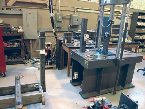

A load “applied in any direction” includes people leaning against the railing or sitting on top of it. But it also means that the railing should be able to resist a load applied from the outside — for instance, a tree that falls against it. We decided to limit our testing to the worst-case scenario — that of a 200-pound load applied from the deck side perpendicular to the very top of the post. Making a connection to resist this force at the base of the post is harder than you might think, because of the lever-arm effect (force x distance): The magnification of this 200-pound horizontal force produces a couple of thousand pounds of load at the base of the post (see “Forces in a Typical Guardrail Post,”).

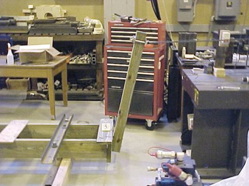

We assumed that the top of the railing was 36 inches above the deck surface (the minimum height allowed by the IRC) and that the deck boards in an actual application are at most 1.5 inches thick. Thus, the horizontal test load was applied to the post 37.5 inches above the top of the simulated deck joists.

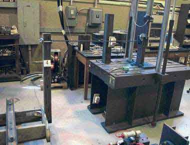

Our test machine applied a measured force, using a roller chain and pulley to redirect its vertical motion to a horizontal force at the top of the post. The post was attached to a simulated deck framing system that included two joists and a band joist with the post attached to the band joist with bolts or lag screws, just as in a real deck. We secured the deck joists to the concrete floor of the lab, and attached a transducer to the joist near the post location to verify that the test assembly didn’t move. We also attached a transducer to the post 37.5 inches above the joist to measure how much it deflected during the test.
Safety factor. The code requirement says that the post must be able to withstand a 200-pound load. But when a structural assembly is tested in a lab, the load gets multiplied by an appropriate safety factor, which is intended to allow for the uncertainties of field installation and the fact that the connections may degrade in service from repeated loading and weathering (but not rot).
We used a safety factor of 2.5, a number that has been in the model codes for decades for testing structural assemblies. So, for our testing, we needed to apply a 500-pound load to determine whether the post connection could be considered “code-conforming.”
