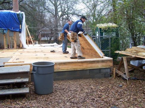

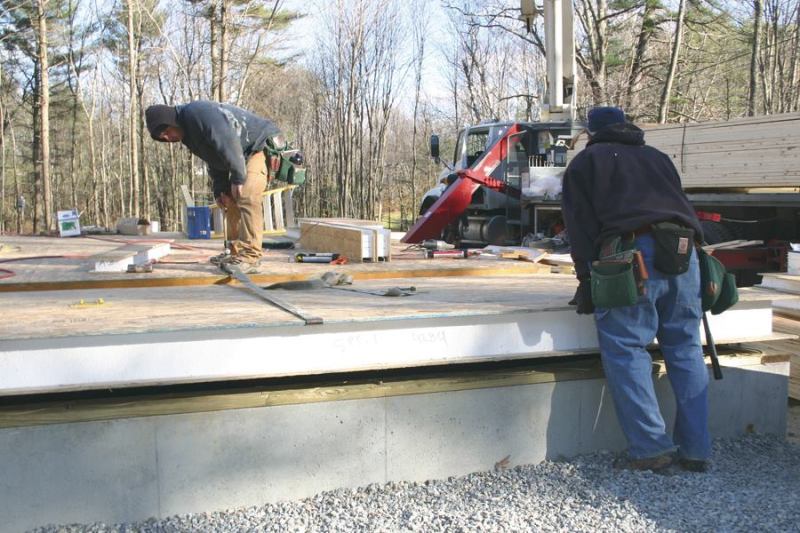

Using floor panels supported by engineered-lumber girders cuts production time on SIP houses.

Sizes. Panels can be made as large as 8 ft. wide and 24 ft. long.
Thicknesses. 4 ½, 6 ½, 8 ¼, 10 ¼, and 12 ¼ inch thicknesses are available. The foam core thicknesses match the width of standard framing lumber. Thicker panels tend to be used for floors and roofs.
Panels generally include built-in wire chases.

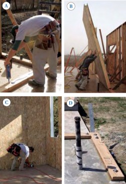

To install wall panels, start by running a bead of sealant along the face and edges of the sole plate (A). Then stand the panels over the plate (B), brace them plumb, and nail the bottom edges to the sides of the plate (C).

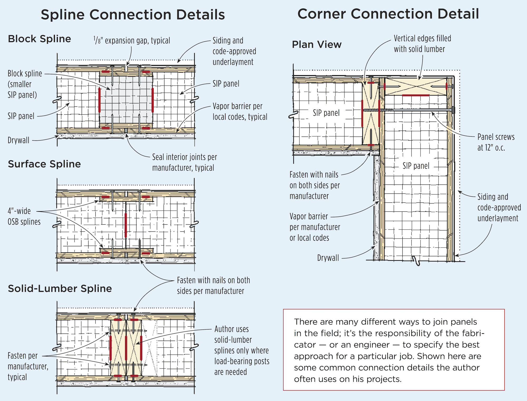

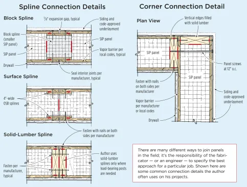

Panels are connected edge-to-edge with splines made from either OSB or solid lumber. The method used on a particular project will be specified by the fabricator or engineer.

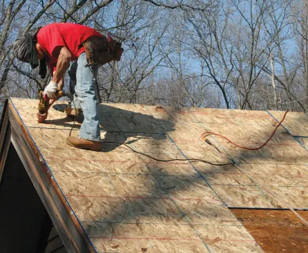

Where wall and roof panels connect, the tops of the wall panels are usually cut to match the roof pitch. Square-cut panels can also be used, but must be fitted with a triangular blocking assembly. However, the assembly and connections must be engineered to transfer loads from the roof to the wall.
A second layer of OSB sheathing was laid over the entire roof.

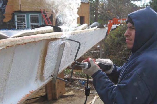

Mistakes and changes can force the crew to alter panels in the field. After trimming panels to size with a circular saw, an electric hot knife must be used to neatly remove the foam so there will be room for a block spline.
