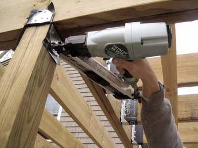

Early copper-based formulations used to replace CCA in pressure-treated wood came with their own set of problems related to the corrosion of metal connectors and fasteners. Despite claims that new “micronized” copper formulas have solved that problem, many coastal contractors still prefer stainless steel fasteners.
But ACQ and CA created a new problem: metal corrosion. They’re not compatible at all with aluminum flashing or aluminum nails, and they also may attack galvanized nails and screws, galvanized flashing, or galvanized connectors and joist hangers. The corrosion issue prompted Simpson Strong-Tie to come out with new, more heavily galvanized hardware, and to recommend exclusive use of stainless steel hangers for coastal areas. Simpson posts information and recommendations about the corrosion issue.
