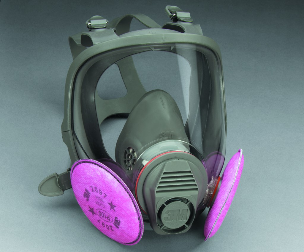

3M Full Facepiece Respirator
Full Facepiece Respirator. Photo courtesy of 3M

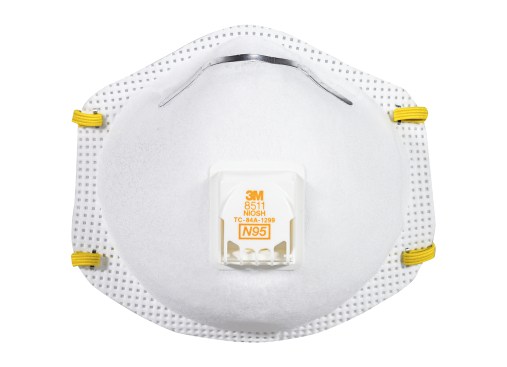

An N95 respirator is one of the most common classification of disposable respirators used in the workplace. A disposable N95 particulate respirator is ideal for a typical construction-type job where there is a lot of nuisance dust from drywall sanding, sawing, and scraping because they are inexpensive, lightweight, and comfortable to wear for longer periods of time.

3M Tekk Protection Paint Sanding Valved Respirator
Valved respirator for painting and sanding. Photo courtesy of 3M

When you get into mold abatement or lead abatement, which include more serious health hazards, there are additional personal protective equipment requirements and the various pieces of PPE have to fit together comfortably in these challenging work conditions. In this environment, a full facepiece respirator is often preferred to protect the eyes and face. A P100 high efficiency particulate filter is used for mold, lead, and asbestos abatement. A coverall is also part of the PPE ensemble, and not just to protect a person’s clothing, but to help keep the hazardous particulates from clinging to the worker’s skin or clothing and potentially transferring those hazards outside of the containment and contaminating other areas.
