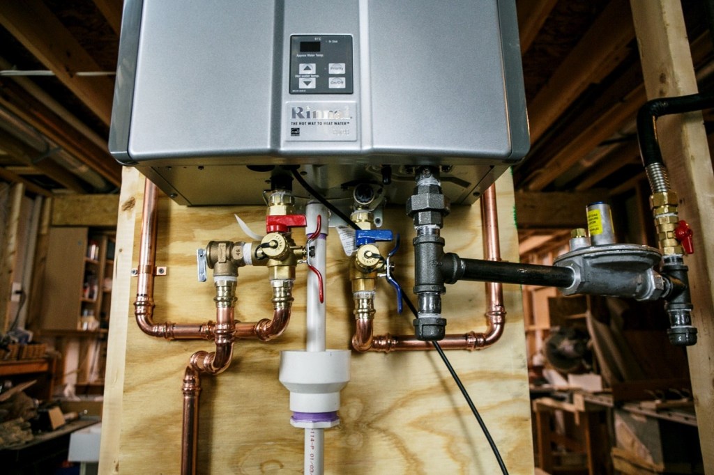

2. Diameter matters
Your traditional tank water heater will likely use a 1/2-inch gas line. However, a tankless model requires more intense heat for shorter periods. That can mean upsizing to a 3/4-inch line to meet the appliance’s Btu demands.
The difference in gas line sizes is the difference between drinking a milkshake with a narrow straw or a wide straw, Marshall illustrates. The smaller line will be slower delivering the necessary Btus to heat up the water. That means the appliance will not operate properly, which can result in wasted energy and premature failure. So just like sizing wiring and other items on the jobsite, gas line sizing can’t be a one-size-fits-all approach.
In the event of a retrofit, you might be able to take advantage of newer piping materials, like CSST (corrugated stainless steel tubing) to replace an undersized line. Because of CSST’s flexible nature, it can be easier to run than rigid iron pipe. You might also be able to take advantage of an elevated pressure system that your local propane provider can help design.
This approach can be an effective workaround. Marshall recommends designing the piping runs to follow the drop chart.

CSST size can vary by manufacturer, and each manufacturer provides line sizing charts for their product. “It can help you get around corners and bends, but you have to make sure it’s sized properly,” Marshall cautions. Also, follow manufactures requirements for fitting installation, and never mix brands of product.
Again, be mindful of the distance of run from the tank to the regulator(s) and regulator to the appliance. Each section of piping must be specifically designed to meet the system’s requirements.
