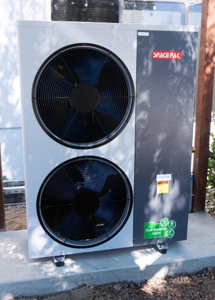

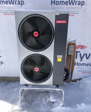

There are two types of equipment for air-to-water heat pump systems, monobloc and split-refrigerant. There are about eight manufacturers actively supplying equipment options for cold climates: Aermec, Arctic Heat Pumps, Chiltrix, Enertech, Nordic, SpacePak, Stiebel Eltron, and Taco Comfort Solutions. Nominal capacities for these manufacturers range between 2 and 6 tons. These cold-climate-rated models can maintain varying levels of capacity and varying coefficients of performance (COP, a measure of heat pump efficiency) below 0°F, but all are designed for cold ambient temperature applications.

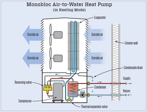

Monobloc systems package all the components of the system in a single outdoor unit that includes the fully charged refrigerant system components, electronics, and heat exchanger from refrigerant to water. Because these systems package everything in the outdoor unit, they require a glycol-mix supply-and-return loop for the water from the storage tank within the house out to the heat pump.
Click to enlarge drawing
A monobloc system packages all the system components, including the fully-charged refrigerant components, electronics, and heat exchanger, in a single outdoor unit. The outdoor unit of a monbloc system (right) has a slightly wider cabinet to accommodate all the components compared with a comparable split-system.

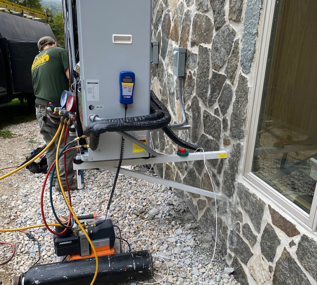

Split-refrigerant systems look and function similarly to other split-system air-source heat pump equipment, with an outdoor compressor/evaporator unit that pipes the compressed refrigerant to an indoor condensing unit. The indoor unit is about the size of a typical mod-con wall-hung boiler that contains the refrigerant-to-water heat exchanger and all of the electronics and controls. The outdoor units for both systems typically have two fans moving air across the refrigerant coils and are about the size of a standard multi-zone ductless unit. Outdoor equipment needs to be set on a frost-protected foundation and with appropriate clearances and considerations for snow and ice as with other air-source heat pump equipment.

A split-refrigerant system has an outdoor compressor/evaporator unit (above left); it pipes compressed refrigerant to an indoor condensing unit (which is about the size of a typical wall-hung modulating condenser boiler; not shown in photo) that contains the refrigerant-to-water heat exchanger and all of the electronics and controls.

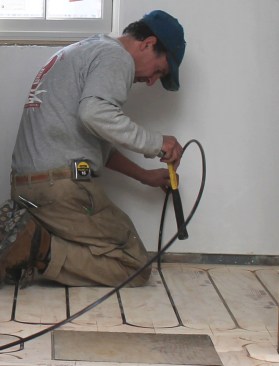

Water as a medium for moving heat energy is superior to air by a wild percentage. A given volume of water can absorb almost 3,500 times as much heat as the same volume of air. What that translates into for the distribution components of an installed system is a 3/4-inch-diameter copper (or PEX-equivalent) tube carrying the same heat energy as the area of an 8×14-inch sheet-metal duct in a forced-air system. This has a major impact on the feasibility and cost of installing a distribution system for a home and frees up space for other ductwork needed for whole-house ventilation systems in modern homes.
Low-temperature, above-floor radiant distribution proves more responsive than radiant slabs. This example uses 5/16-inch PEX tubing set in channeled panels installed directly over 3/4-inch subfloor.

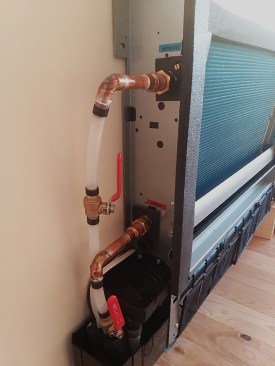

A low-temperature panel radiator, such as the Mestek thinwall heating/cooling fan coil shown at left, is another distribution option that is both more efficient and more responsive than a traditional fin-tube radiator.

There are a variety of low-temperature hydronic emitters available that can be flexible and intermixed for various application needs in a building. Examples of low-temp emitters include low-temperature baseboard units, wall panel radiators, low-mass radiant floors, ductless wall- or floor-mounted fan-coil units, and even hydronic air-coils for use in fully ducted distribution delivery systems. The shared characteristic of all these emitter types is that they are optimized for low-temperature water by maximizing the surface area that the water “sees” while moving through or across the emitter. The choice of which emitter type to use can depend on the aesthetic choice of the occupants, but also more importantly, the Btu input needs of the individual rooms within a home.

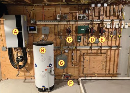

Interior split-refrigerant system setup: A. Indoor split-refrigerant system components; B. 40-gallon-capacity buffer/thermal storage tank with 6-kw/20-kBtu backup electric resistance elements; C. Buffer tank injection pump; D. First-floor-zone, 3-speed, 3/4-hp circulator pump; E. Second-floor-zone, 3-speed, 3/4-hp circulator pump; F. Return-side 3/4-hp circulator; G. Expansion tank.
