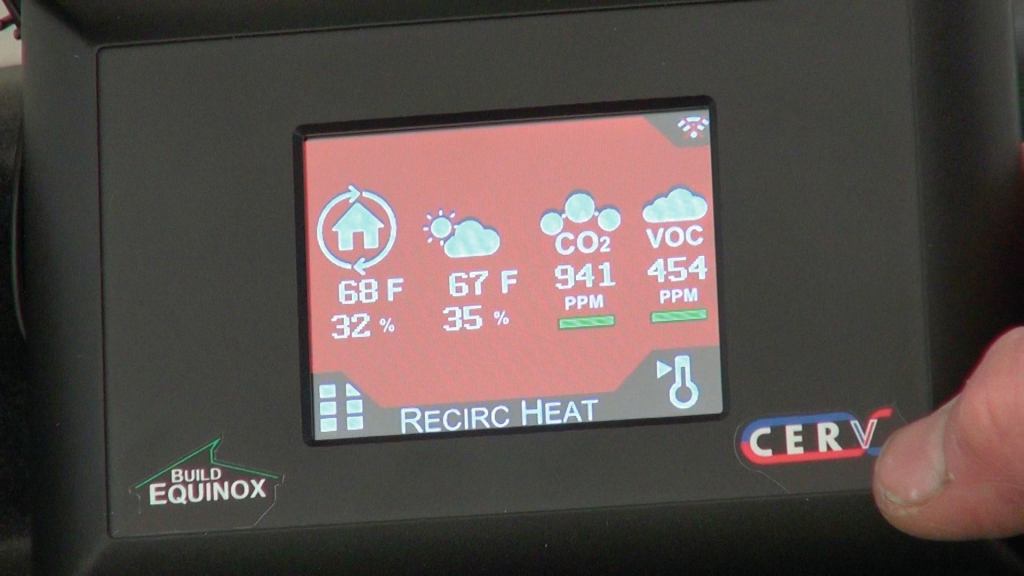

A close-up of the remote-control display for the Build Equinox shows readouts for temperature, humidity, carbon dioxide, and volatile organic compounds. The CERV's "black box" sensor and control system continously monitors CO2 levels, VOC levels, and temperature in the occupied rooms, and implements air exchange as needed to keep air quality within parameters selected by the occupant.

Build Equinox systems also come with a “black box” smart control system that senses humidity, carbon dioxide (CO2), and volatile organic compounds (VOCs) in the air, turning the system fans and heat pump on and off as needed to address the building’s actual pollutant load and humidity conditions, rather than using a timer to determine the flow of ventilation air. When fresh air isn’t needed, the black box responds to variations in house temperatures, operating in recirculation, or “recirc,” mode to move air around and maintain an even temperature.

The CERV also manages indoor air quality in the small dwellings, “continually evaluating the indoor air quality with CO2 and VOC sensors in the return airstream,” says Schneider. “The occupant sets the desired ppm for the air quality (we recommend 1,000 ppm) and the CERV recirculates the air unless the ppm is exceeded, and then it brings in outside air. The CERV exhausts air from the kitchen and bathrooms and supplies air to the living areas and bedrooms.”
