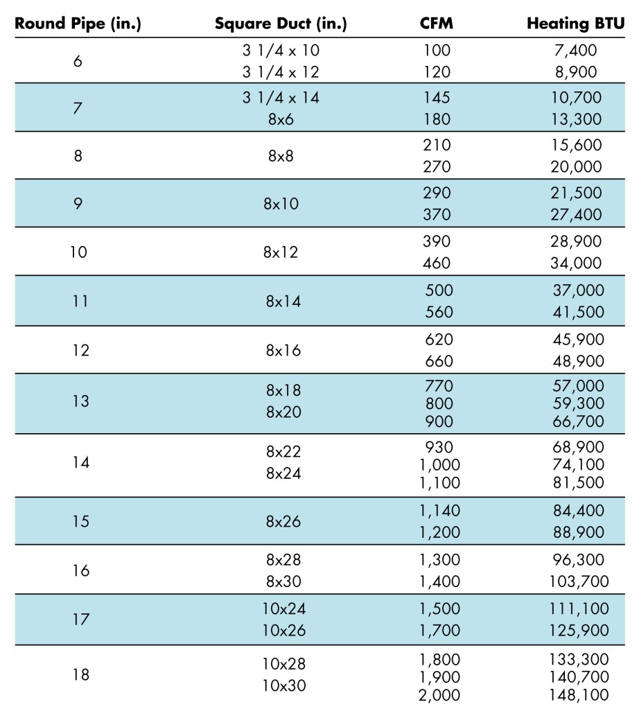

Duct Sizing
The size of supply and return registers (grilles), airflow capacity per room, and the size and layout of ductwork should all be determined by using ACCA Manual D (preferably, by using current computer software approved by the ACCA). Approximate sizing can be determined using the table below.
