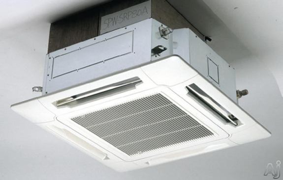

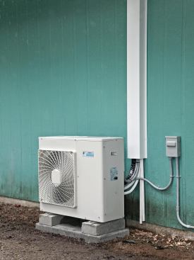

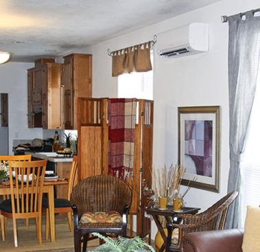

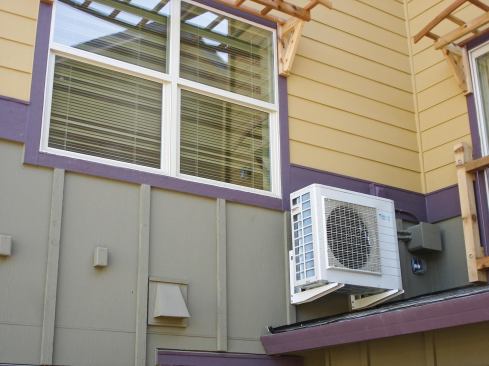

Going ductless. The output from any heat-pump system — whether ground- or air-source — can be distributed by way of a conventional duct system served by a central air handler. But the ductless systems I’ll be talking about in this article consist of an outdoor unit — made up of a coil, a fan, and an inverter-driven variable-speed compressor — connected by refrigerant lines to one or more indoor fan-coil units, each of which is equipped with a filter, a coil, and a multispeed blower to distribute the conditioned air (see Figure 1).
These kinds of systems are often called mini-splits, to distinguish them from through-the-wall “motel units” that combine the compressor and fan coils in a single package, as in a conventional room air conditioner. But to avoid confusing consumers, we follow NEEA’s lead and refer to them as ductless heat pumps.
