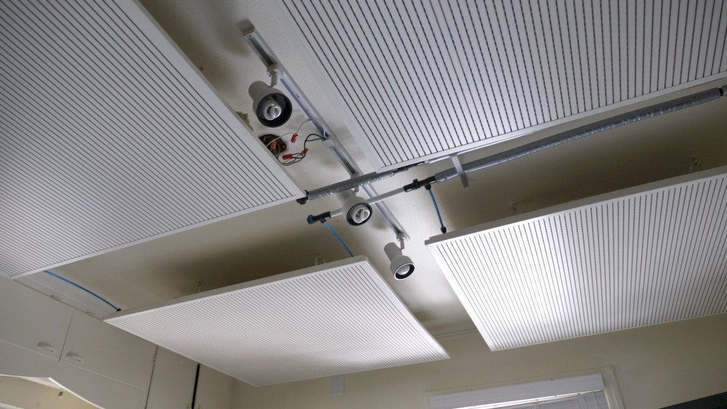

These are architectural panels that could be free standing on a ceiling or wall.  These panels are more suited to a commercial installation. In a residence, special drywall panels can also be used to mimic a conventional drywall ceiling.  In both cases, tubes are pre-built into the backside to distribute chilled water over the ceiling area.

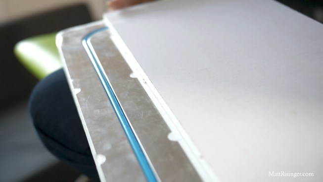

This is the back of a drywall radiant panel. The tubes are embedded in metal to spread the cold out to a larger surface area.

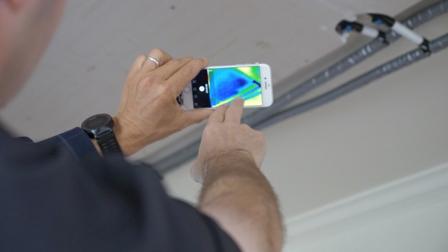

The blue on the IR image on Matt's phone clearly shows the cooler temperature of the radiant cooling panel.

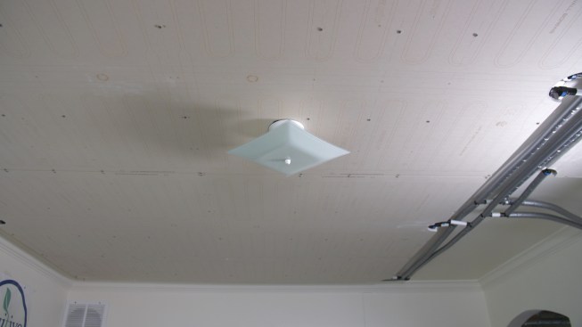

This is how drywall radiant ceiling panels look before they are mudded. The piping (seen to the right on this experimental installation at the Positive Energy offices) would be buried in the ceiling and panels skim coated, so it would look like an ordinary drywall ceiling and you'd never know there were radiant panels inside.
