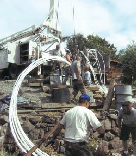

A well-drilling crew lowers a bundle of PEX piping into a thermal well that will heat a Klamath Falls medical office. Black iron pipe, long the traditional choice for downhole heat exchangers, tends to corrode in the hot mineral-rich groundwater, and typically must be replaced every 20 years or so.
