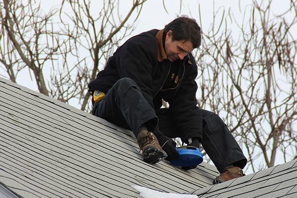

ReVision Energy's Phil Coupe checks the solar exposure of a rooftop on Peaks Island, in Portland, Maine. Solar arrays combined with mini-split air-source heat pumps have helped some island residents drastically cut back their consumption of costly heating oil.
