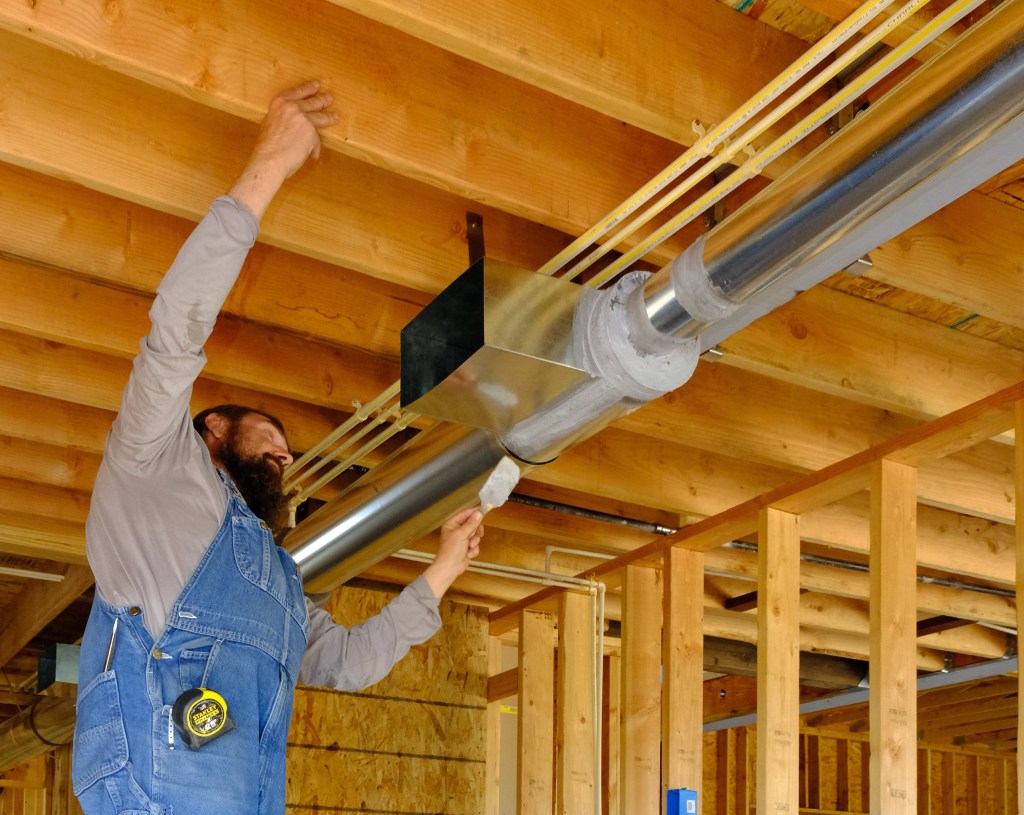

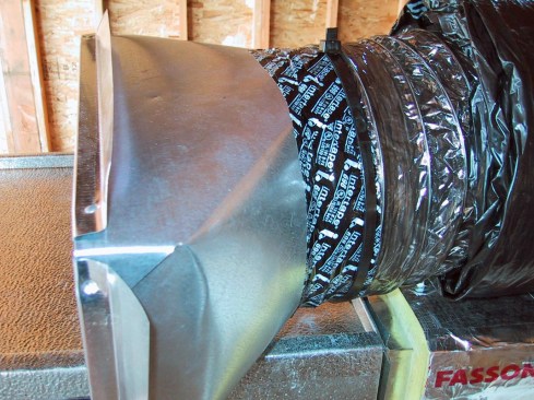

Inverter-driven heat pumps can function with conventional ductwork to move air where it’s needed and to match the comfort requirements that customers expect. Smooth-wall ducts and all connections sealed with mastic will ensure efficient delivery of supply air.
Photo by Steve Easley

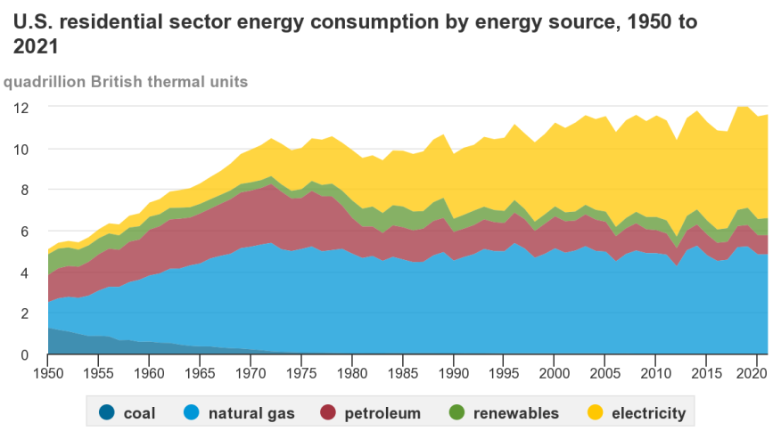

In 2021, residential consumption of electricity and renewables (totaling 5.87 quadrillion Btu) surpassed natural gas and petroleum (5.76 quadrillion Btu). Source: U.S. Energy Information Administration.

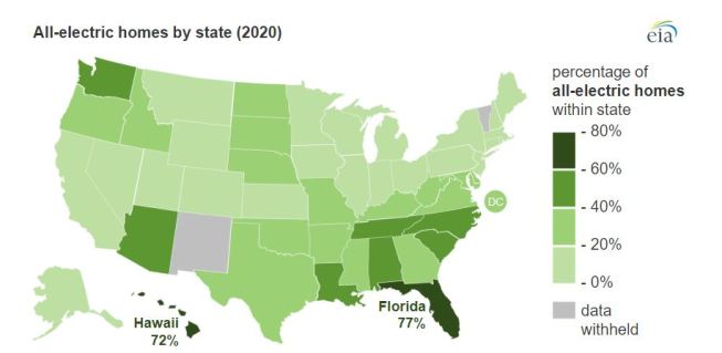

We’re on that path already: According to the Energy Information Administration (EIA), natural gas and electricity are the two biggest sources of energy used in U.S. homes. Figures from the EIA’s Residential Energy Consumption Survey show that natural gas was used in 58% of homes in 2015 but that usage fell to 42% in 2020 and is now running almost neck and neck with the consumption of electricity, which has taken over as the biggest source of residential energy use, at 43%. Space heating accounts for about 43% of a home’s energy use and water heating adds an additional 19%. Heat pumps offer a real solution—possibly the only technology solution we currently have—to providing the space and water heating portion because they make such efficient use of electrical energy.
In 2020, 26% of U.S. households used electricity as the only source of energy (32.25 million out of 123.53 million homes), according to our 2020 Residential Energy Consumption Survey (RECS). The number of all-electric homes is lower in colder climates where natural gas still dominates as the fuel-type for space heating and water heating, but that number is expected to grow as consumers and building professionals become more familiar with cold-climate heat pumps.

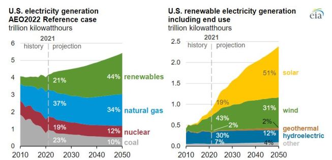

The Energy Information Administration predicts that U.S. power generation from renewables will increase from 21% in 2021 to 44% in 2050. Source: U.S. Energy Information Administration Annual Energy Outlook 2022.

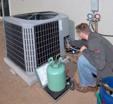

Heat pumps that operate in heating mode must be charged properly. Using liquid refrigerant, the charging is performed with the proper charge weighed in to the high side of the system using an accurate charging scale.

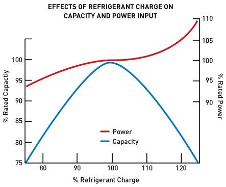

Refrigerant charge. Failure to charge an ASHP to 100% has a severe impact on not only the unit’s rated capacity but also on power draw. As you can see in the chart at left, overcharging and undercharging can create a big drop-off in capacity and a surge in power consumption once you move off a 100% charge.

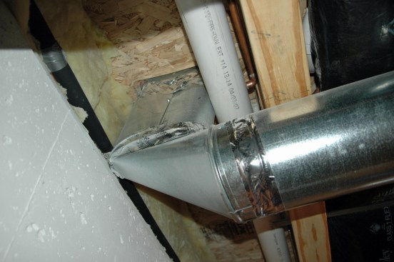

Pressure testing, which ensures a leak-free refrigerant line, is essential to maintaining refrigerant charge.
Photo by Ted Cushman

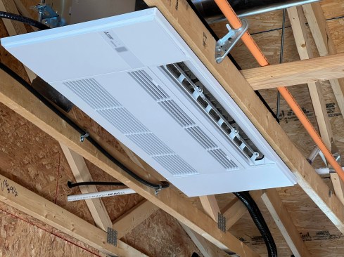

Not all indoor mini-split heat pumps have to be wall units. The author used seven of these Mitsubishi ceiling cassettes on his own home to zone control heating and cooling. These cassettes are very quiet.
Photos by Steve Easley

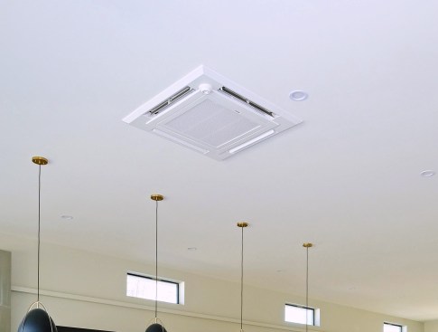

This ceiling cassette can be used for large spaces. It moves air in four directions and includes an infrared sensor that can detect heat signatures in the room and direct air flow away from or toward people, depending on their comfort preferences.

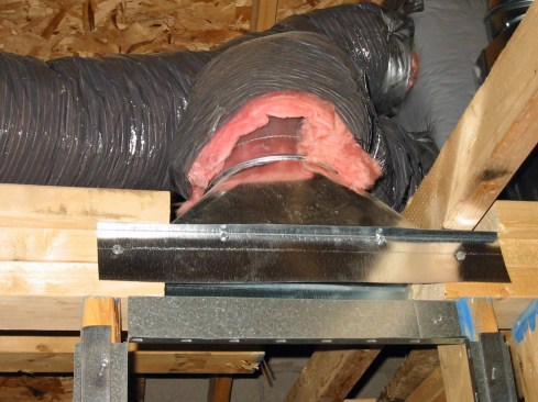

Inverter-driven units can also function with conventional ductwork to move air where it’s needed and to match the comfort requirements that customers expect. Regardless of the heating system, all ducts should be sized per ACCA Manual D calculations. All bedrooms need return air ducts, or jump ducts, and grilles designed to Manual D specifications. (Don’t rely on undercutting doors. If you need 200 cfm of return air to a room, you would have to undercut the typical 30-inch-wide door 3.2 inches!) Be sure to seal ducts using mastic or an appropriate tape (no rubber-based adhesives) and test to keep the total leakage below 5 cfm per 100 square feet of conditioned floor area or the amount of duct leakage to the outside under 4 cfm (these are minimums for tested leakage per the building code). You can do a lot better than this. Ductwork outside conditioned space should always be insulated to at least R-8. This is even more important for heat pumps since they can have lower register discharge temperatures; poorly insulated ducts will drive winter discharge temperatures even lower.

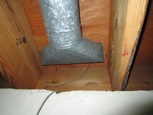

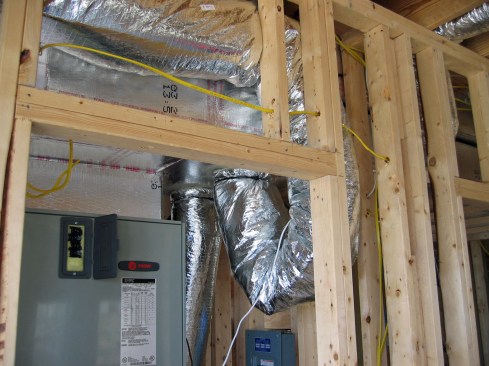

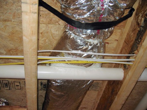

How ducts are run through homes has an impact on both airflow and leakage. Keep runs straight with no kinks or crushed areas.
For heat pumps, it’s even more critical to understand that duct leakage is not simply about losing conditioned air along the way and not delivering it to rooms. With any system, duct leakage creates pressure imbalances within the home. Supply-side leaks in an attic, basement, or crawlspace will create negative air pressures in the living space, which can pull outdoor air into the space and increase the loads and lengthen the amount of time the unit takes to reach the thermostat set point. Leaks on the return side will create positive pressures in the living space that will force conditioned air out of the building. This is no different than a forced-air system that burns fossil fuels, but again, because the recovery time is so much slower with a conventional ASHP, the impact will be more noticeable.
Duct leakage, of course, becomes a much smaller problem when the ducts are brought inside the living space. Too often, they are running through an attic or crawlspace that is effectively at the outdoor air temperature in winter, and, in attics, significantly hotter than outdoor temperatures in summer.

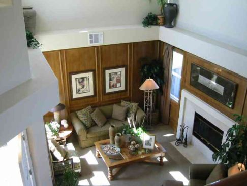

An example of how ducts can be brought inside the living space. Here, ductwork is incorporated into the design of the home using a soffit around the perimeter of rooms.
Maintaining good airflow through the ducts is also essential. It’s important that installers measure the airflow at supply registers to confirm the design airflow. Flex duct creates enormous air friction, which combines with tight bends and restrictions to drop airflow well below the desired flow rate. You might have the best unit in the world, but it’s useless if you can’t deliver conditioned air to rooms. When using flex duct, attach boots and couplers to framing members so you can stretch the duct to reduce friction loss. Make sure ducts are straight runs and have wide, smooth bends that keep static pressures low.
